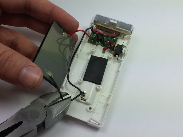

  4. Nokero N400 Solar Panel Replacement, Solar Panel: crwdns2935265:04crwdnd2935265:01crwdnd2935265:02crwdne2935265:0 Nokero N400 Solar Panel Replacement, Solar Panel: crwdns2935265:04crwdnd2935265:02crwdnd2935265:02crwdne2935265:0
    • Pull the panel away from the rest of the assembly and cut the red and black wires coming from the panel
    • Be careful not to cut the ground-wire for the motherboard, it is the same color and goes to the exact same place as the solar panel wire.
    • For reassembly you will need to either splice, or solder the wires onto the replacement.
