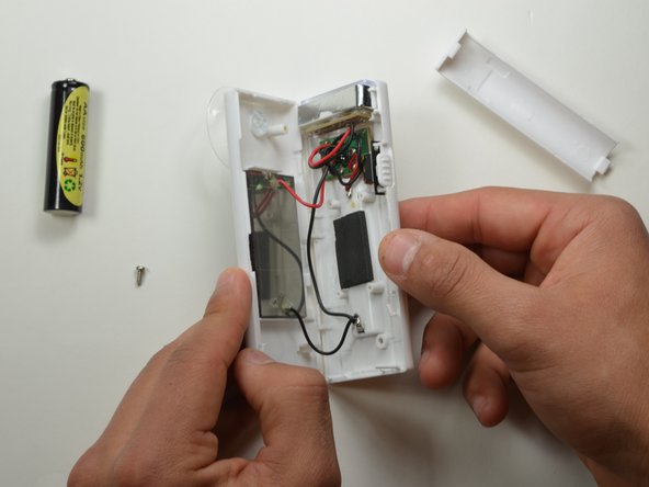

  2. Nokero N400 LED Panel Replacement, Unscrew Back Cover: crwdns2935265:02crwdnd2935265:01crwdnd2935265:02crwdne2935265:0 Nokero N400 LED Panel Replacement, Unscrew Back Cover: crwdns2935265:02crwdnd2935265:02crwdnd2935265:02crwdne2935265:0
    • Remove the 7mm Phillips #1 screw.
  3. Nokero N400 LED Panel Replacement, Pry Open Back Cover: crwdns2935265:03crwdnd2935265:01crwdnd2935265:02crwdne2935265:0 Nokero N400 LED Panel Replacement, Pry Open Back Cover: crwdns2935265:03crwdnd2935265:02crwdnd2935265:02crwdne2935265:0
    • Place the plastic opening tool in between the two plastic panels and slowly work your way around the device.
    • Unlatch the clips on the inside and pull device apart.
    • Some clips will break when forced open.

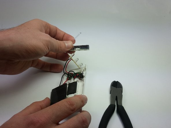

  4. Nokero N400 LED Panel Replacement, Removing the LED Panel: crwdns2935265:04crwdnd2935265:01crwdnd2935265:02crwdne2935265:0 Nokero N400 LED Panel Replacement, Removing the LED Panel: crwdns2935265:04crwdnd2935265:02crwdnd2935265:02crwdne2935265:0
    • With the back cover of the device removed, lightly pull up on the LED assembly to lift it out of its housing.
    • The LED assembly will separate into three components; the light board, outer housing, and plastic lens.
  5. Nokero N400 LED Panel Replacement: crwdns2935265:05crwdnd2935265:01crwdnd2935265:01crwdne2935265:0
    • Set the outer housing and plastic lens aside.
    • Take a pair of pliers and cut the red and black wires connected to the light board.
    • Make sure to cut just below the light board.
    • To install the new light board, you will need to splice or solder the wires to the new light board.
