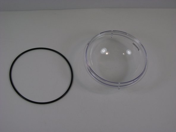

    • Grasp the clear cover and the white housing and twist the cover counter-clockwise.
    • The lid may hold fast, but it will come off with some firm twisting.
  2. Nokero N222-Huron O-Ring Replacement: crwdns2935265:02crwdnd2935265:01crwdnd2935265:01crwdne2935265:0
    • Lift the lid from the device
    • It may be helpful to use a spudger to pry under the lid if there is difficulty in getting a good grip on the smooth plastic.

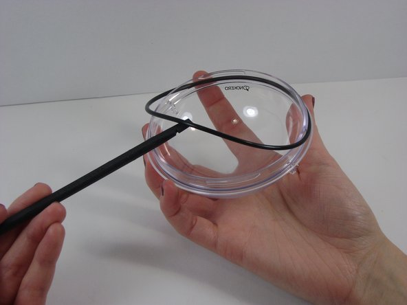

  3. Nokero N222-Huron O-Ring Replacement, O-Ring: crwdns2935265:03crwdnd2935265:01crwdnd2935265:03crwdne2935265:0 Nokero N222-Huron O-Ring Replacement, O-Ring: crwdns2935265:03crwdnd2935265:02crwdnd2935265:03crwdne2935265:0 Nokero N222-Huron O-Ring Replacement, O-Ring: crwdns2935265:03crwdnd2935265:03crwdnd2935265:03crwdne2935265:0
    • Using a plastic spudger, lift the o-ring from the lid
  4. Nokero N222-Huron O-Ring Replacement: crwdns2935265:04crwdnd2935265:01crwdnd2935265:01crwdne2935265:0
    • Gently stretch the new O-ring and place it in position on the clear cover. Make sure it is flush with the flange and not interfering with the locking threads
