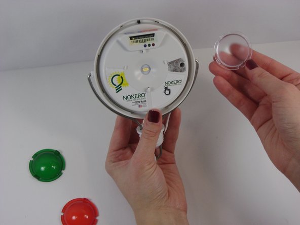

    • Grasp the clear cover and the white housing and twist the cover counter-clockwise.
    • The lid may hold fast, but it will come off with some firm twisting.

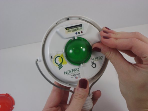

    • Turn the lens until the slots line up with the retaining clips on the device.
    • Lift the lens off of the device. It should come off easily.

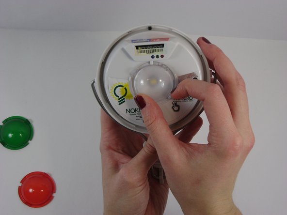

    • When reinstalling the lends, line up the slots of the new lens with the retaining clips, and rotate the lens counter-clockwise.
    • You will hear an audible click when the lens is locked in place.
To reassemble your device, follow the instructions for the first two steps in reverse order.
