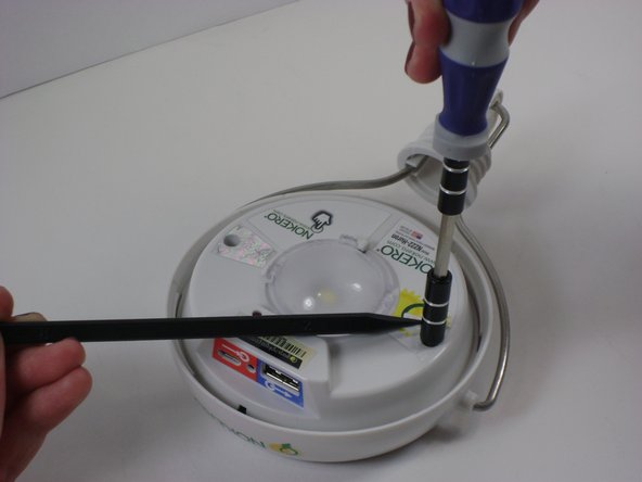

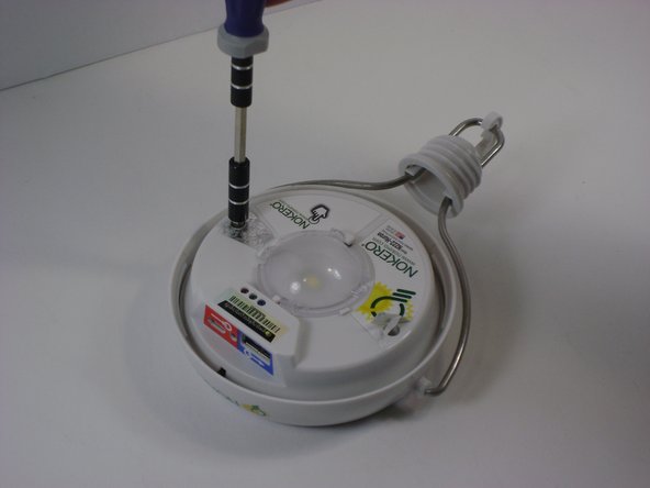

  3. Nokero N222-Huron Battery Replacement, Battery: crwdns2935265:03crwdnd2935265:01crwdnd2935265:03crwdne2935265:0 Nokero N222-Huron Battery Replacement, Battery: crwdns2935265:03crwdnd2935265:02crwdnd2935265:03crwdne2935265:0 Nokero N222-Huron Battery Replacement, Battery: crwdns2935265:03crwdnd2935265:03crwdnd2935265:03crwdne2935265:0
    • Remove the two #1 Phillips screws hidden underneath stickers on the face of the device. Use a plastic spudger to carefully peel back the metallic sticker that reads, “Warranty Void if Removed” and the Nokero sticker as shown in the picture.
    • In case there was any question, removing this sticker and taking your device apart will void the warranty

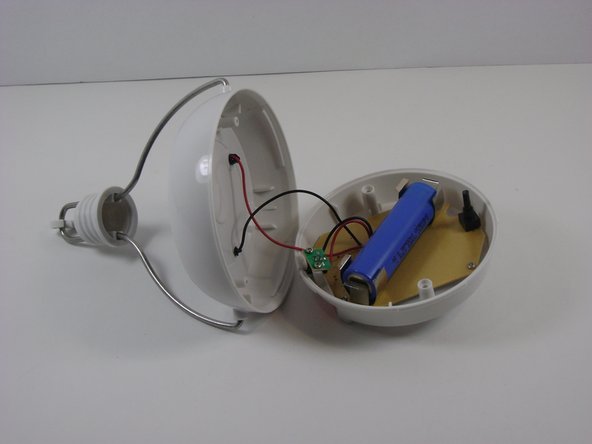

    • Carefully separate the two halves of the device. You will notice a red and a black wire connecting the solar panel to the circuit board. Set the device as shown to keep the wires relaxed.
    • If the halves of the device are separated too quickly, it is possible for the wires to be strained or to come loose from the circuit board. If this happens, the wires will need to be resoldered to the board.
  5. Nokero N222-Huron Battery Replacement: crwdns2935265:05crwdnd2935265:01crwdnd2935265:01crwdne2935265:0
    • Remove the battery from the clips and set aside
    • The battery can be replaced by any 18650 battery found online, but the device battery is a 1400mAh, 3.2V battery. Keep in mind that the light will last longer with a higher mAh rated battery, but it will also take longer to fully charge, especially when using the solar panel.
