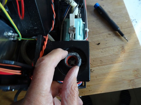

  7. Nivona Caferomatica 770 Replace water supply seal, Water supply gasket: crwdns2935265:07crwdnd2935265:01crwdnd2935265:03crwdne2935265:0 Nivona Caferomatica 770 Replace water supply seal, Water supply gasket: crwdns2935265:07crwdnd2935265:02crwdnd2935265:03crwdne2935265:0 Nivona Caferomatica 770 Replace water supply seal, Water supply gasket: crwdns2935265:07crwdnd2935265:03crwdnd2935265:03crwdne2935265:0
    • The water connection seal is covered with a plastic cap. This cap is fixed with two Torx T10 screws. Unscrew both screws.
    • Lift out the cap with your fingers.
    • Lift out the water connection seal with your fingers.
    • Grease the seal thinly with food-grade silicone grease before installation. The gasket must be inserted with the flat side facing up.
Work through the steps in reverse order to reassemble your device.
