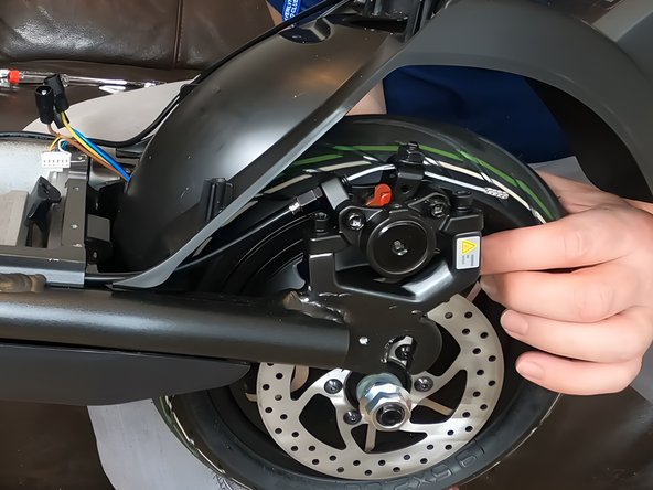

    • Use a floor jack or center stand to lift the scooter, making it easier to remove the tire.
    • Remove the sticker that covers the the Mortorq drive screw under it.

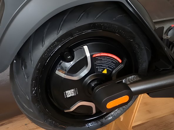

    • Use the pliers to remove the cotter pin and loosen the nut securing the rear wheel to the axle.
    • Use the tire lever to pry the tire off the rim of the wheel.

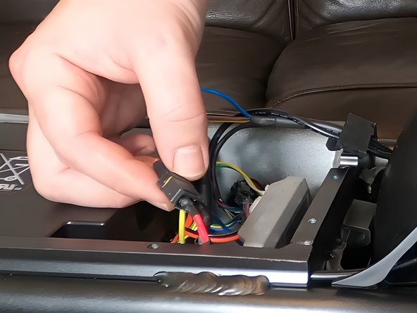

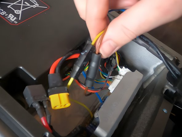

    • Remove the inner tube from the tire and rim.
    • Detach the connectors so you're able to completely remove the tire.

it looks like the descriptions do not match the pictures or actual repair. for example the kqi series of scooters do not use innertubes. they are tubeless pneumatic tires (similar to on a standard car)
also the images show disconnecting of the battery pack (and thus having removed the deck of the scooter) but nowhere is the description does it say to do that
