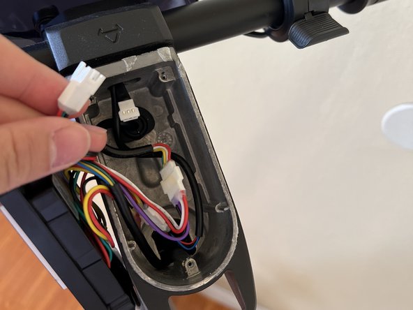

    • Use a spudger to slowly open the display cap.

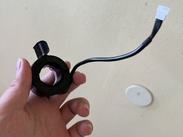

  2. Niu Kqi2 Pro Scooter Thumb Throttle Replacement: crwdns2935265:02crwdnd2935265:01crwdnd2935265:01crwdne2935265:0
    • Remove the three screws using a Phillips screwdriver.
  3. Niu Kqi2 Pro Scooter Thumb Throttle Replacement: crwdns2935265:03crwdnd2935265:01crwdnd2935265:02crwdne2935265:0 Niu Kqi2 Pro Scooter Thumb Throttle Replacement: crwdns2935265:03crwdnd2935265:02crwdnd2935265:02crwdne2935265:0

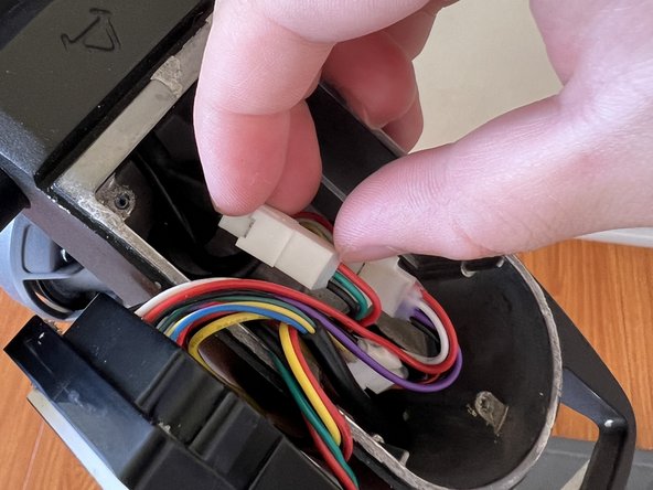

    • Lift open the dashboard.
    • Unplug the wire connection that has the red, green, and black wires.
  4. Niu Kqi2 Pro Scooter Thumb Throttle Replacement: crwdns2935265:04crwdnd2935265:01crwdnd2935265:03crwdne2935265:0 Niu Kqi2 Pro Scooter Thumb Throttle Replacement: crwdns2935265:04crwdnd2935265:02crwdnd2935265:03crwdne2935265:0 Niu Kqi2 Pro Scooter Thumb Throttle Replacement: crwdns2935265:04crwdnd2935265:03crwdnd2935265:03crwdne2935265:0

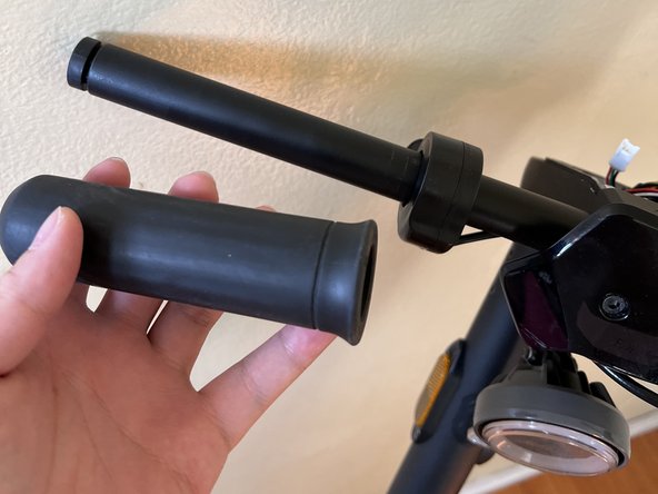

    • Using the provided Hex wrench or your own Hex wrench, unscrew to loosen up the thumb throttle.
    • Remove the hand grip on the handle before removing your old thumb throttle.
  5. Niu Kqi2 Pro Scooter Thumb Throttle Replacement: crwdns2935265:05crwdnd2935265:01crwdnd2935265:03crwdne2935265:0 Niu Kqi2 Pro Scooter Thumb Throttle Replacement: crwdns2935265:05crwdnd2935265:02crwdnd2935265:03crwdne2935265:0 Niu Kqi2 Pro Scooter Thumb Throttle Replacement: crwdns2935265:05crwdnd2935265:03crwdnd2935265:03crwdne2935265:0

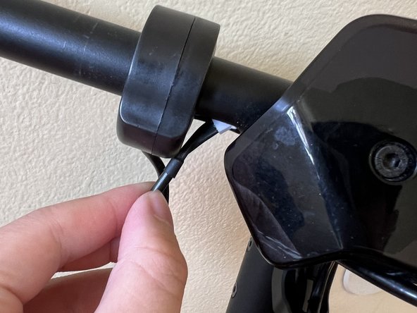

    • Insert the new thumb throttle back into the handle.
    • Feed the wiring into the interior of the dashboard bay.
    • Align the wire connection back, ensuring red goes with red, green goes with green, and black goes with black.
