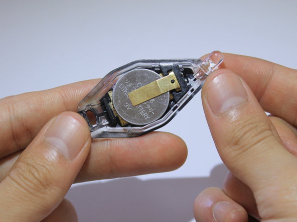

Use this guide to change the case of a microlight.
    1. Nite Ize Inova Microlight Casing Replacement, Case Removal: crwdns2935265:01crwdnd2935265:01crwdnd2935265:02crwdne2935265:0 Nite Ize Inova Microlight Casing Replacement, Case Removal: crwdns2935265:01crwdnd2935265:02crwdnd2935265:02crwdne2935265:0
      • Insert the plastic opening tool into the seam of the device.
    2. Nite Ize Inova Microlight Casing Replacement, Battery Removal: crwdns2935265:02crwdnd2935265:01crwdnd2935265:03crwdne2935265:0 Nite Ize Inova Microlight Casing Replacement, Battery Removal: crwdns2935265:02crwdnd2935265:02crwdnd2935265:03crwdne2935265:0 Nite Ize Inova Microlight Casing Replacement, Battery Removal: crwdns2935265:02crwdnd2935265:03crwdnd2935265:03crwdne2935265:0
      • Squeeze the top battery using a tweezer and pull the battery away from the light bulb.
      • Repeat this step for the bottom remaining battery.
      • Do not pull up on the battery as this will bend the metal contact.

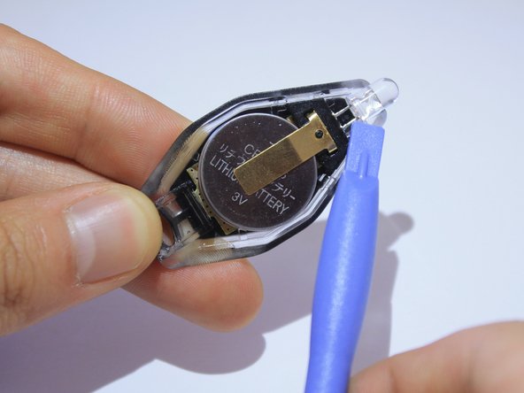

    1. Nite Ize Inova Microlight Casing Replacement, LED Light Removal: crwdns2935265:03crwdnd2935265:01crwdnd2935265:03crwdne2935265:0 Nite Ize Inova Microlight Casing Replacement, LED Light Removal: crwdns2935265:03crwdnd2935265:02crwdnd2935265:03crwdne2935265:0 Nite Ize Inova Microlight Casing Replacement, LED Light Removal: crwdns2935265:03crwdnd2935265:03crwdnd2935265:03crwdne2935265:0
      • Place the plastic opening tool below the LED lamp and push away from the device until you hear a click.
      • Continue to remove the LED lamp the with your fingers.
    2. Nite Ize Inova Microlight Casing Replacement, Logic Board Removal: crwdns2935265:04crwdnd2935265:01crwdnd2935265:01crwdne2935265:0
      • Place the plastic opening tool behind the logic board and bend away from the casing
    3. Nite Ize Inova Microlight Casing Replacement, Logic Board Removal: crwdns2935265:05crwdnd2935265:01crwdnd2935265:01crwdne2935265:0
      • The logic board will pop out with ease.
