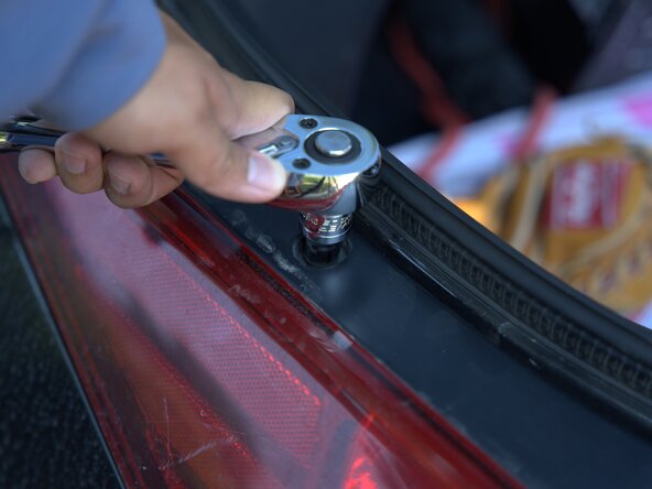

  2. Nissan 350Z Tail Light Replacement: crwdns2935265:02crwdnd2935265:01crwdnd2935265:02crwdne2935265:0 Nissan 350Z Tail Light Replacement: crwdns2935265:02crwdnd2935265:02crwdnd2935265:02crwdne2935265:0

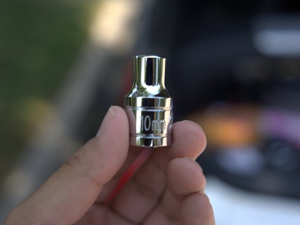

    • Look for the 3 bolts that secure the tail light to the car.
    • Attach your 10MM socket to your 1/4 inch ratchet.

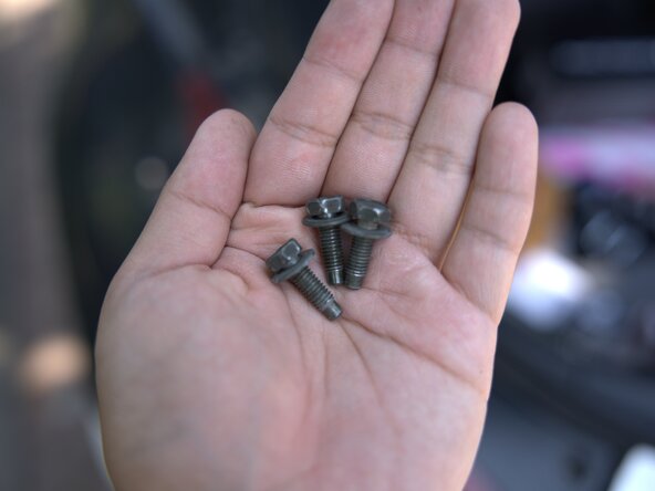

  3. Nissan 350Z Tail Light Replacement: crwdns2935265:03crwdnd2935265:01crwdnd2935265:02crwdne2935265:0 Nissan 350Z Tail Light Replacement: crwdns2935265:03crwdnd2935265:02crwdnd2935265:02crwdne2935265:0
    • Using your 10MM socket and 1/4 inch ratchet remove the three bolts.
    • Make sure to keep the bolts together and in a safe place.

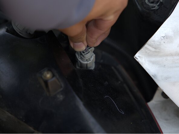

  4. Nissan 350Z Tail Light Replacement: crwdns2935265:04crwdnd2935265:01crwdnd2935265:01crwdne2935265:0
    • Hold both ends of the headlight and carefully remove the assembly.
    • You may need to use some force when pulling, as dowel pins secure it to the car.
    • You can flip the tail light over and place it in the tail light cavity so you do not have to hold it.

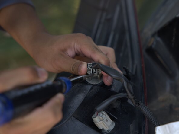

  5. Nissan 350Z Tail Light Replacement: crwdns2935265:05crwdnd2935265:01crwdnd2935265:03crwdne2935265:0 Nissan 350Z Tail Light Replacement: crwdns2935265:05crwdnd2935265:02crwdnd2935265:03crwdne2935265:0 Nissan 350Z Tail Light Replacement: crwdns2935265:05crwdnd2935265:03crwdnd2935265:03crwdne2935265:0
    • Check the underside of the connector for a square-shaped slot.
    • Insert your flathead screwdriver into the square tab to disconnect the connector.
    • If you are having trouble with this part, try to push the tab in then down.

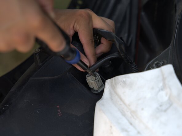

  6. Nissan 350Z Tail Light Replacement: crwdns2935265:06crwdnd2935265:01crwdnd2935265:02crwdne2935265:0 Nissan 350Z Tail Light Replacement: crwdns2935265:06crwdnd2935265:02crwdnd2935265:02crwdne2935265:0
    • Reconnect the tail light cable connector to the new tail light assembly.
    • Press the connector firmly into the socket to ensure a secure connection.
