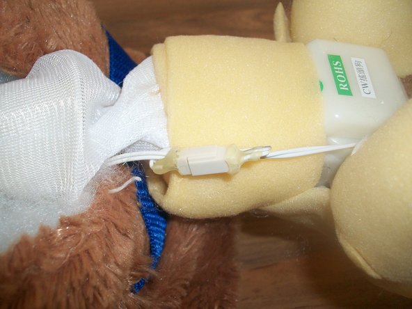

    • Gently ease head from fur cover to gain access to wire clip.
    • Unclip wire connectors for head.

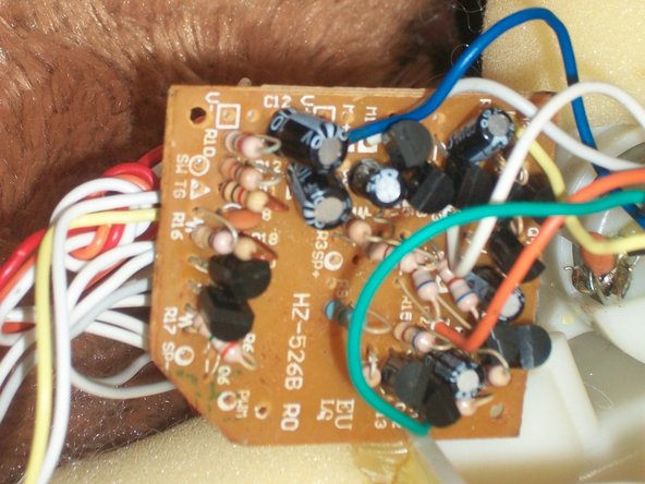

    • Spaghetti junction! The motherboard is sitting vertically inside the box. To lever it out use a flathead screwdriver between the uppermost board edge and the plastic casing.(marked on photo in pink) Push the screwdriver so that the edge of board lifts and you are able to grab with your fingers.

    • You can see here the 3 wires we will be working with but which wire does what?
    • Turning the board over you will be able to see the red wire is labelled v positive, white wire is v negative and the orange is SW (Abbreviation for SWitch)
    • Carefully desolder the 3 wires for the old battery pack. Feed the new battery pack wires through from front of toy. Solder the new battery pack wires on ensuring that the correct wires are on the correct terminals of motherboard.
