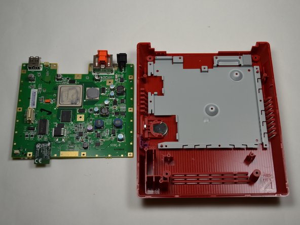

This guide details the replacement of the motherboard on a Nintendo Wii Mini. The steps shown in the images are of the disassembly process, and the replacement and reassembly are as simple as completing the steps in reverse.
An electrostatic discharge bracelet is recommended when handing delicate electronics.
A motherboard replacement may be necessary when these symptoms occur in your Wii Mini : Wii does not turn on or will not boot up after power supply is found to be working.

    3. Nintendo Wii mini Motherboard Replacement, Unscrew the Metal Casing: crwdns2935265:012crwdnd2935265:01crwdnd2935265:02crwdne2935265:0 Nintendo Wii mini Motherboard Replacement, Unscrew the Metal Casing: crwdns2935265:012crwdnd2935265:02crwdnd2935265:02crwdne2935265:0
      • Using a Phillips #0 screwdriver, remove the eleven 5 mm screws holding the silver metal plate to the console.
      • These screws are indicated by small arrows on the metal plate. (See Photo #2)
    4. Nintendo Wii mini Motherboard Replacement, Remove Metal Casing: crwdns2935265:013crwdnd2935265:01crwdnd2935265:02crwdne2935265:0 Nintendo Wii mini Motherboard Replacement, Remove Metal Casing: crwdns2935265:013crwdnd2935265:02crwdnd2935265:02crwdne2935265:0
      • Lift out the metal plate and set it aside.
    5. Nintendo Wii mini Motherboard Replacement, Remove Motherboard: crwdns2935265:014crwdnd2935265:01crwdnd2935265:02crwdne2935265:0 Nintendo Wii mini Motherboard Replacement, Remove Motherboard: crwdns2935265:014crwdnd2935265:02crwdnd2935265:02crwdne2935265:0
      • Lift out the motherboard and set it aside.
