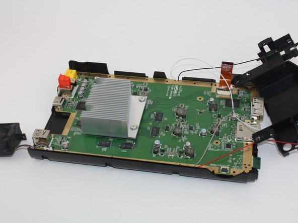

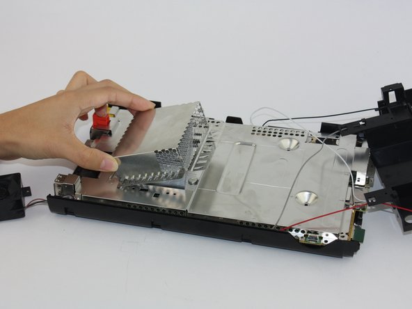

    • Unscrew and remove the heatsink. You will have to carefully move the antenna cables out of the way in order to remove the heatsink shielding.

    • Using a Phillips #1 unscrew all floor screws connecting the outer plate from the circuit board to remove the circuit board.

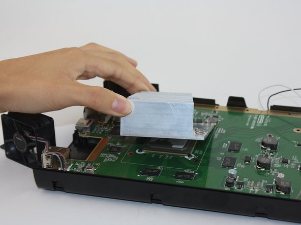

    • Using a Phillips #1 unscrew the 4 screws securing the heatsink to the motherboard and remove the heatsink.

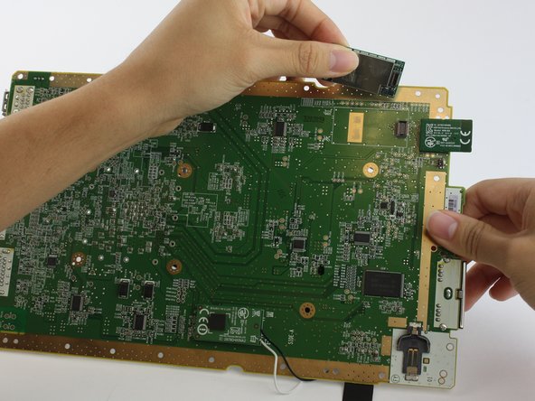

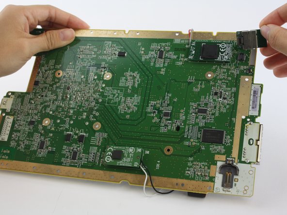

    • Locate the screws lining the perimeter of the motherboard that you will remove with a Phillips #1 screwdriver. Once they are unscrewed, the motherboard should easily separate from the lower tray.
    • Once the motherboard is detached, flip it over to view the wireless modules.
  13. Nintendo Wii U Wireless and Bluetooth Module Replacement: crwdns2935265:013crwdnd2935265:01crwdnd2935265:03crwdne2935265:0 Nintendo Wii U Wireless and Bluetooth Module Replacement: crwdns2935265:013crwdnd2935265:02crwdnd2935265:03crwdne2935265:0 Nintendo Wii U Wireless and Bluetooth Module Replacement: crwdns2935265:013crwdnd2935265:03crwdnd2935265:03crwdne2935265:0
    • Pull up gently on the wireless modules to avoid breakage.
