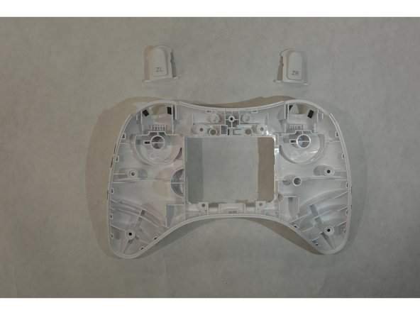

    • Once all of the screws are removed, simply use one hand to hold the front panel in place and lift up on the back panel to remove it. Place the back panel so the insides are facing up towards you.
  5. Nintendo Wii U Pro Controller ZL and ZR Button Replacement: crwdns2935265:05crwdnd2935265:01crwdnd2935265:02crwdne2935265:0 Nintendo Wii U Pro Controller ZL and ZR Button Replacement: crwdns2935265:05crwdnd2935265:02crwdnd2935265:02crwdne2935265:0
    • Locate the two triggers (ZL and ZR) and pop them up and out by pressing on them from the outside.
