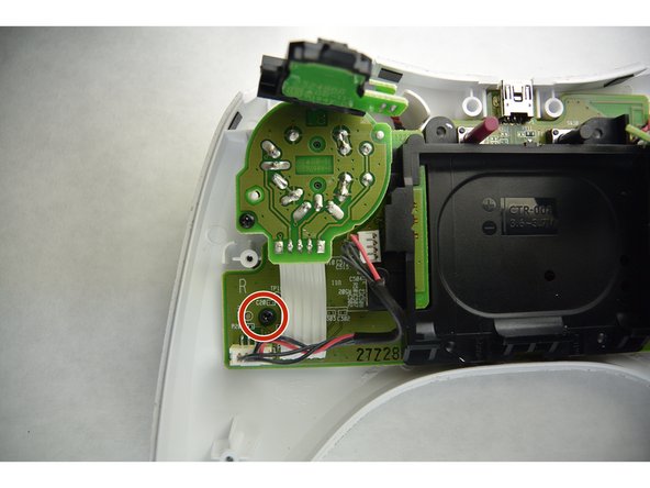

  5. Nintendo Wii U Pro Controller ABXY Buttons Replacement: crwdns2935265:05crwdnd2935265:01crwdnd2935265:01crwdne2935265:0
    • Move the right trigger and sensor out of the way.
    • Remove the 4 mm JIS #0 screw.

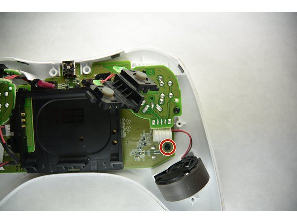

  6. Nintendo Wii U Pro Controller ABXY Buttons Replacement: crwdns2935265:06crwdnd2935265:01crwdnd2935265:01crwdne2935265:0
    • Move the left trigger and sensor out of the way.
