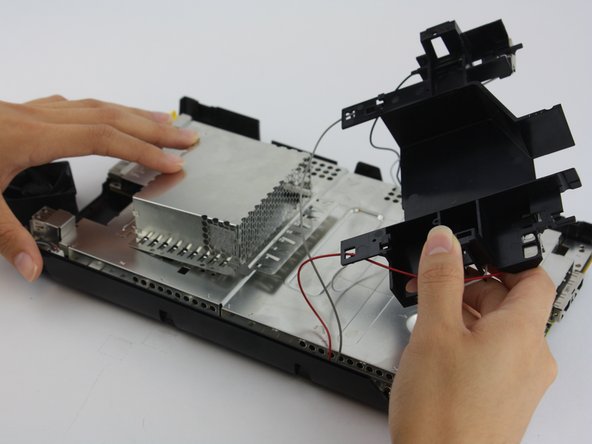

  12. Nintendo Wii U Motherboard Replacement, Motherboard: crwdns2935265:012crwdnd2935265:01crwdnd2935265:03crwdne2935265:0 Nintendo Wii U Motherboard Replacement, Motherboard: crwdns2935265:012crwdnd2935265:02crwdnd2935265:03crwdne2935265:0 Nintendo Wii U Motherboard Replacement, Motherboard: crwdns2935265:012crwdnd2935265:03crwdnd2935265:03crwdne2935265:0
    • Remove the black plastic shielding by unscrewing connecting screws with a Phillip's Head screwdriver.
    • You will have to carefully adjust the antenna cables out of the way in order to proceed comfortably.

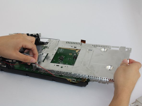

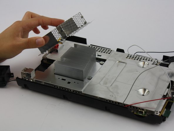

  13. Nintendo Wii U Motherboard Replacement: crwdns2935265:013crwdnd2935265:01crwdnd2935265:03crwdne2935265:0 Nintendo Wii U Motherboard Replacement: crwdns2935265:013crwdnd2935265:02crwdnd2935265:03crwdne2935265:0 Nintendo Wii U Motherboard Replacement: crwdns2935265:013crwdnd2935265:03crwdnd2935265:03crwdne2935265:0
    • The metal cap does not require unscrewing and should lift up with ease.
    • Unscrew all the screws that outline the perimeter of the board using a Phillips Head (PH1) screwdriver.
    • Remove the silver shielding plate once all screws are removed. Be careful when pulling it under the affixed antenna cables.
