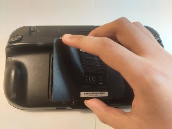

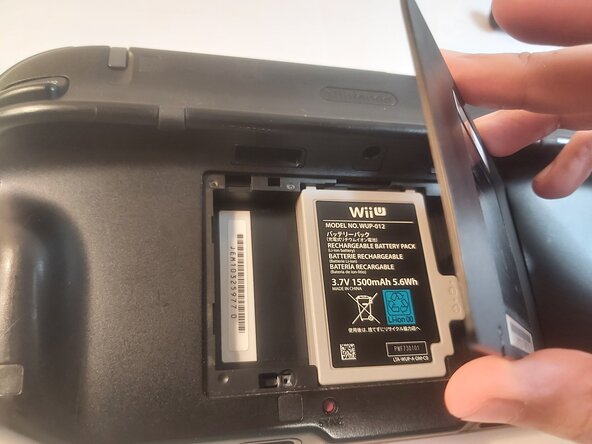

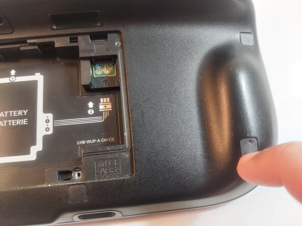

    • Place the Wii U gamepad on a soft surface or use minimal force to avoid placing pressure on the joysticks and screen.
    • Loosen the two 4.7 mm screws located on the bottom using a Phillips #00 screwdriver.

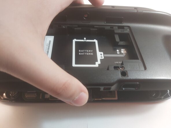

    • Unlatch and remove the cover to unveil the battery.

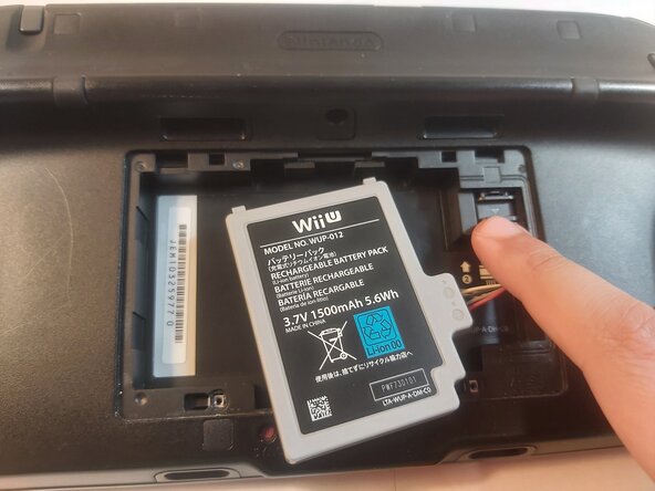

  2. Nintendo Wii U Gamepad ZL and ZR Triggers Replacement: crwdns2935265:02crwdnd2935265:01crwdnd2935265:02crwdne2935265:0 Nintendo Wii U Gamepad ZL and ZR Triggers Replacement: crwdns2935265:02crwdnd2935265:02crwdnd2935265:02crwdne2935265:0
    • Grab the battery by the sides and gently remove it from the slot.
    • Gently press down on the wire's latch to disconnect the battery.
    • Remove the battery and set it aside.
  3. Nintendo Wii U Gamepad ZL and ZR Triggers Replacement: crwdns2935265:03crwdnd2935265:01crwdnd2935265:02crwdne2935265:0 Nintendo Wii U Gamepad ZL and ZR Triggers Replacement: crwdns2935265:03crwdnd2935265:02crwdnd2935265:02crwdne2935265:0
    • Gently slide your fingernails under the ten rubber pads to remove them and reveal the hidden screws.
    • A thin tool or pin can be used to remove the plastic covers.

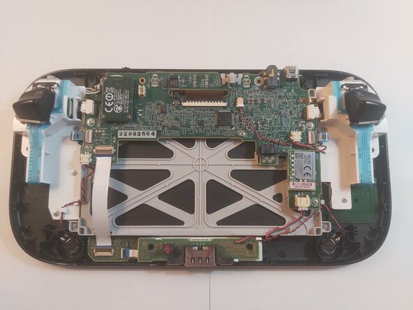

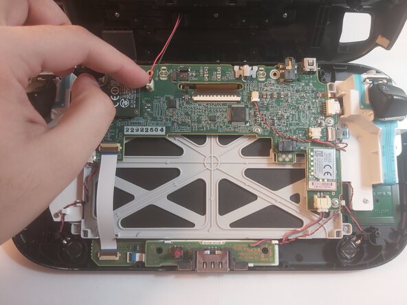

  4. Nintendo Wii U Gamepad ZL and ZR Triggers Replacement: crwdns2935265:04crwdnd2935265:01crwdnd2935265:03crwdne2935265:0 Nintendo Wii U Gamepad ZL and ZR Triggers Replacement: crwdns2935265:04crwdnd2935265:02crwdnd2935265:03crwdne2935265:0 Nintendo Wii U Gamepad ZL and ZR Triggers Replacement: crwdns2935265:04crwdnd2935265:03crwdnd2935265:03crwdne2935265:0
    • Remove the ten 8.9 mm Tri-wing Y1 backplate screws.
    • Gently open the backplate by lifting it from the bottom to unveil the internals.
    • Gently remove the plastic wire connecting the backplate to the board.
    • Do not rip open the backplate to avoid damaging the Gamepad.

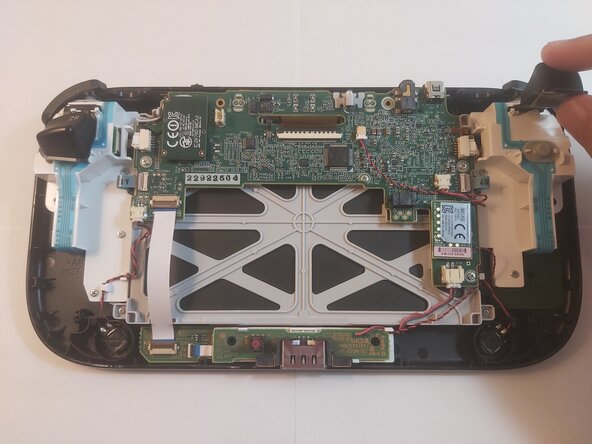

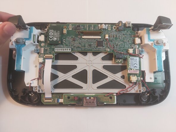

  5. Nintendo Wii U Gamepad ZL and ZR Triggers Replacement: crwdns2935265:05crwdnd2935265:01crwdnd2935265:03crwdne2935265:0 Nintendo Wii U Gamepad ZL and ZR Triggers Replacement: crwdns2935265:05crwdnd2935265:02crwdnd2935265:03crwdne2935265:0 Nintendo Wii U Gamepad ZL and ZR Triggers Replacement: crwdns2935265:05crwdnd2935265:03crwdnd2935265:03crwdne2935265:0
    • Gently lift and slide the ZL and ZR triggers off to remove them from the slot.
  6. Nintendo Wii U Gamepad ZL and ZR Triggers Replacement: crwdns2935265:06crwdnd2935265:01crwdnd2935265:03crwdne2935265:0 Nintendo Wii U Gamepad ZL and ZR Triggers Replacement: crwdns2935265:06crwdnd2935265:02crwdnd2935265:03crwdne2935265:0 Nintendo Wii U Gamepad ZL and ZR Triggers Replacement: crwdns2935265:06crwdnd2935265:03crwdnd2935265:03crwdne2935265:0
    • Insert the new triggers by gently sliding them into the ZL and ZR spots respectively.
    • Continue to reassembling the Gamepad.
