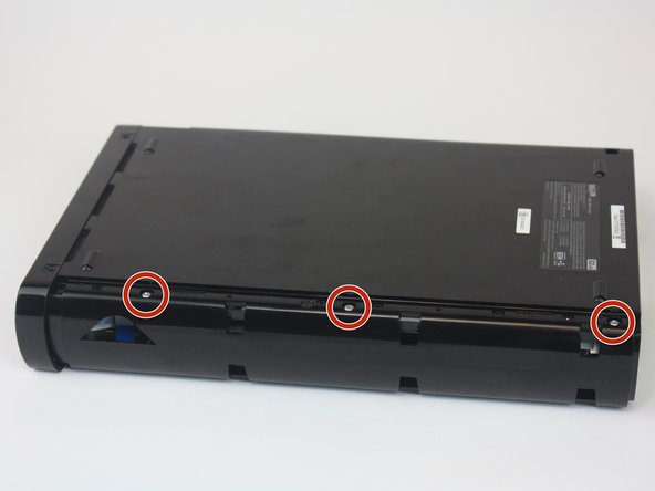

    • Remove the CMOS battery door on the left side of the console.
    • Once the door is removed, remove the three Phillips #0 screws.

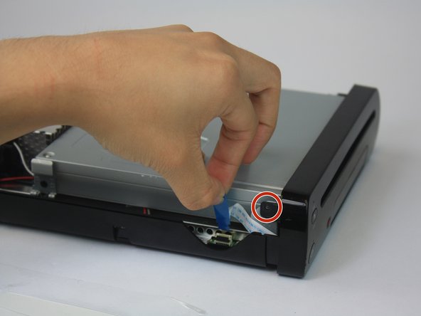

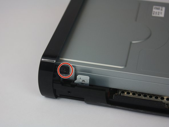

    • Rotate the device so that the front plate is facing you.
    • Remove the two Phillips #1 screws.

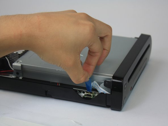

  6. Nintendo Wii U Button Replacement: crwdns2935265:06crwdnd2935265:01crwdnd2935265:03crwdne2935265:0 Nintendo Wii U Button Replacement: crwdns2935265:06crwdnd2935265:02crwdnd2935265:03crwdne2935265:0 Nintendo Wii U Button Replacement: crwdns2935265:06crwdnd2935265:03crwdnd2935265:03crwdne2935265:0

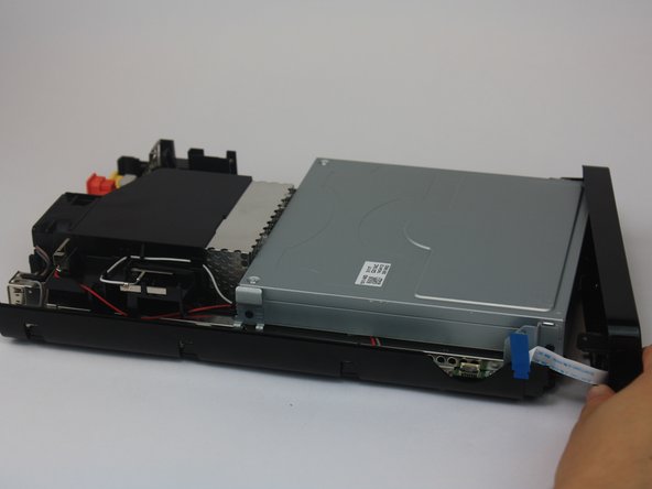

    • Remove the ribbon cable and separate the front plate from the main console.
