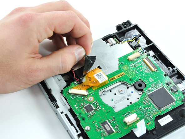

    3. Nintendo Wii DVD Drive Lens Replacement: crwdns2935265:025crwdnd2935265:01crwdnd2935265:02crwdne2935265:0 Nintendo Wii DVD Drive Lens Replacement: crwdns2935265:025crwdnd2935265:02crwdnd2935265:02crwdne2935265:0
      • Remove the piece of black cloth tape that covers a portion of the lens ribbon cable.

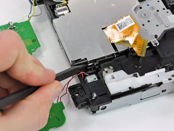

    8. Nintendo Wii DVD Drive Lens Replacement: crwdns2935265:030crwdnd2935265:01crwdnd2935265:01crwdne2935265:0
      • Lay the DVD drive board next to the DVD drive in such a manner that the cables soldered to the DVD drive board are out of the way (as shown in the picture)
      • Remove the single 5.0 mm Phillips screw from the DVD lens EMI shield.

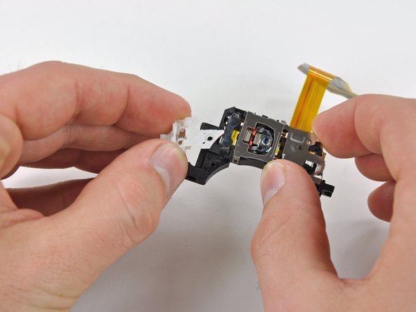

    16. Nintendo Wii DVD Drive Lens Replacement: crwdns2935265:038crwdnd2935265:01crwdnd2935265:02crwdne2935265:0 Nintendo Wii DVD Drive Lens Replacement: crwdns2935265:038crwdnd2935265:02crwdnd2935265:02crwdne2935265:0
      • Remove the 4.2 mm Phillips screw that secures the white plastic bracket to the lens assembly.
      • Lift the bracket off the lens assembly.
      • If you are going to install a new lens, make sure to transfer the white plastic bracket and screw to the new laser lens before installation.
