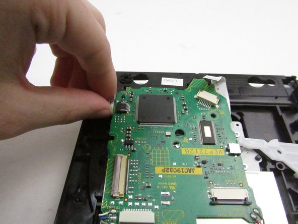

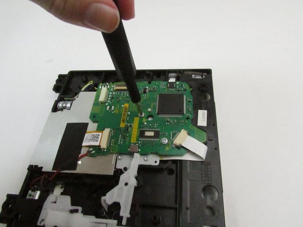

  22. Nintendo Wii 2011 DVD Reader Data Cable Replacement, DVD Reader Data Cable: crwdns2935265:022crwdnd2935265:01crwdnd2935265:02crwdne2935265:0 Nintendo Wii 2011 DVD Reader Data Cable Replacement, DVD Reader Data Cable: crwdns2935265:022crwdnd2935265:02crwdnd2935265:02crwdne2935265:0
    • Use the Phillips screwdriver to remove two 3 mm screws.
    • Remove the disc drive board.

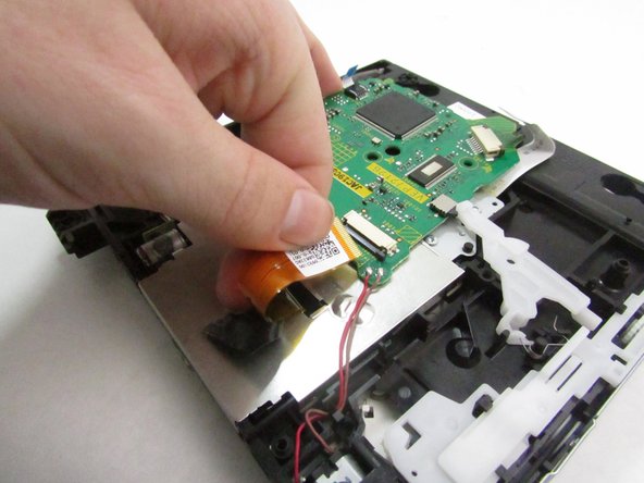

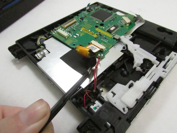

  23. Nintendo Wii 2011 DVD Reader Data Cable Replacement: crwdns2935265:023crwdnd2935265:01crwdnd2935265:03crwdne2935265:0 Nintendo Wii 2011 DVD Reader Data Cable Replacement: crwdns2935265:023crwdnd2935265:02crwdnd2935265:03crwdne2935265:0 Nintendo Wii 2011 DVD Reader Data Cable Replacement: crwdns2935265:023crwdnd2935265:03crwdnd2935265:03crwdne2935265:0
    • Pinch the two cables with your thumb and index finger and pull each cable straight out from the plug-in port.

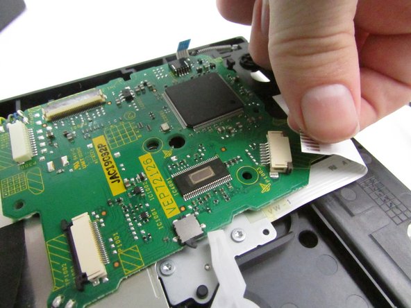

  24. Nintendo Wii 2011 DVD Reader Data Cable Replacement: crwdns2935265:024crwdnd2935265:01crwdnd2935265:03crwdne2935265:0 Nintendo Wii 2011 DVD Reader Data Cable Replacement: crwdns2935265:024crwdnd2935265:02crwdnd2935265:03crwdne2935265:0 Nintendo Wii 2011 DVD Reader Data Cable Replacement: crwdns2935265:024crwdnd2935265:03crwdnd2935265:03crwdne2935265:0
    • Use tweezers to remove the sticker holding the cables down.
    • Pinch the cable with your thumb and index finger and pull straight out.

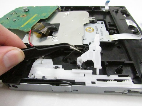

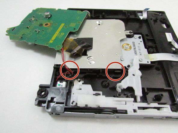

  25. Nintendo Wii 2011 DVD Reader Data Cable Replacement: crwdns2935265:025crwdnd2935265:01crwdnd2935265:03crwdne2935265:0 Nintendo Wii 2011 DVD Reader Data Cable Replacement: crwdns2935265:025crwdnd2935265:02crwdnd2935265:03crwdne2935265:0 Nintendo Wii 2011 DVD Reader Data Cable Replacement: crwdns2935265:025crwdnd2935265:03crwdnd2935265:03crwdne2935265:0
    • There will be one screw and four clips holding the plate in place.
    • Use the tweezers to pry up each of the four clips on both sides of the metal plate.
    • Slide and lift the metal plate simultaneously toward the end of the DVD disc drive where the board is located.

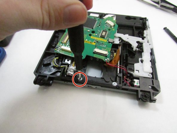

  26. Nintendo Wii 2011 DVD Reader Data Cable Replacement: crwdns2935265:026crwdnd2935265:01crwdnd2935265:02crwdne2935265:0 Nintendo Wii 2011 DVD Reader Data Cable Replacement: crwdns2935265:026crwdnd2935265:02crwdnd2935265:02crwdne2935265:0
    • Remove the screw using a Phillips screwdriver.

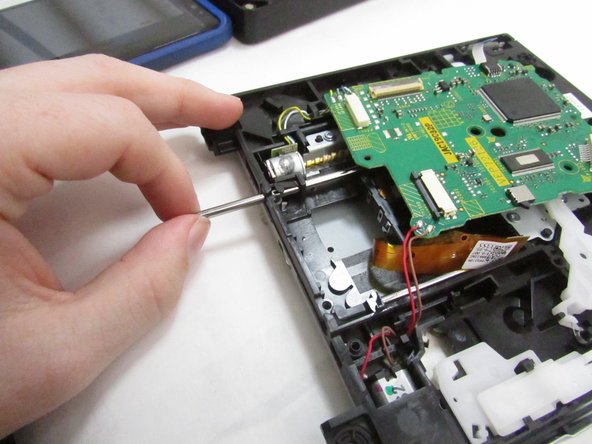

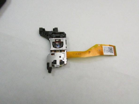

  27. Nintendo Wii 2011 DVD Reader Data Cable Replacement: crwdns2935265:027crwdnd2935265:01crwdnd2935265:03crwdne2935265:0 Nintendo Wii 2011 DVD Reader Data Cable Replacement: crwdns2935265:027crwdnd2935265:02crwdnd2935265:03crwdne2935265:0 Nintendo Wii 2011 DVD Reader Data Cable Replacement: crwdns2935265:027crwdnd2935265:03crwdnd2935265:03crwdne2935265:0
    • Use the tweezers to lift up the plastic piece.
    • Use your fingers to pull out the metal shaft.
    • Lift the optical drive from the disc drive.
  28. Nintendo Wii 2011 DVD Reader Data Cable Replacement: crwdns2935265:028crwdnd2935265:01crwdnd2935265:01crwdne2935265:0
    • Remove the Phillips screw that secures the white plastic bracket to the lens assembly.
    • Lift the bracket off the lens assembly.
    • If you are going to install a new lens, make sure to transfer the white plastic bracket and screw to the new laser lens before installation.
