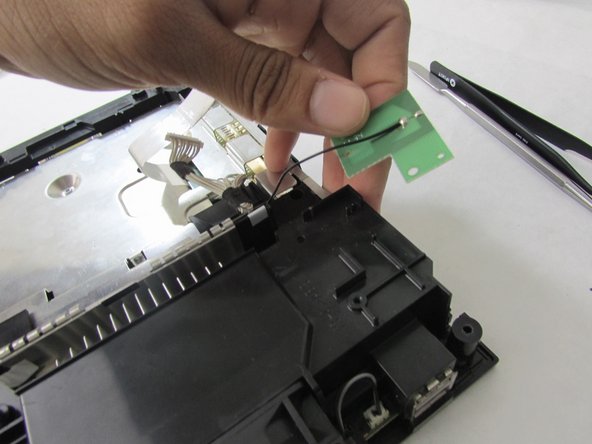

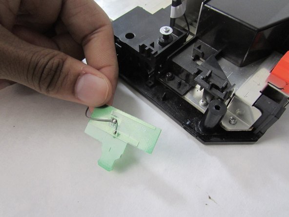

  22. Nintendo Wii 2011 Bluetooth and Wi-Fi Boards Replacement, Bluetooth and WiFi Boards: crwdns2935265:022crwdnd2935265:01crwdnd2935265:01crwdne2935265:0
    • After gaining access to the boards unscrew the 3mm screws holding the Bluetooth and Wi-Fi boards in place using the Philips #0 screwdriver.
  23. Nintendo Wii 2011 Bluetooth and Wi-Fi Boards Replacement: crwdns2935265:023crwdnd2935265:01crwdnd2935265:03crwdne2935265:0 Nintendo Wii 2011 Bluetooth and Wi-Fi Boards Replacement: crwdns2935265:023crwdnd2935265:02crwdnd2935265:03crwdne2935265:0 Nintendo Wii 2011 Bluetooth and Wi-Fi Boards Replacement: crwdns2935265:023crwdnd2935265:03crwdnd2935265:03crwdne2935265:0
    • Remove the circuit boards by carefully lifting and pulling away from the device.
    • Using the soldering kit, heat and take the solder off the wires connecting the Bluetooth and Wi-Fi boards.
    • Using the soldering kit re-solder the wiring back onto the same area it was removed from the circuit board.
    • Use caution when soldering as the iron is hot. If you are unfamiliar with solder, check out the article on the topic.
