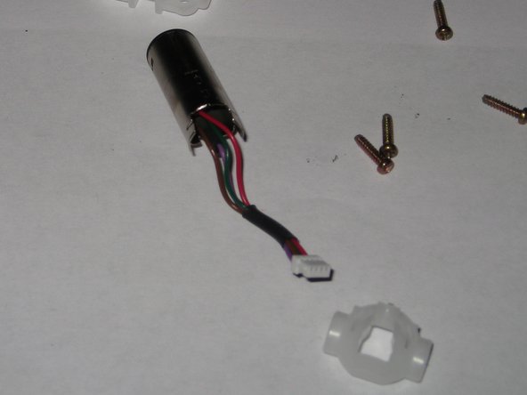

    • Remove four tri-wing screws to remove the connector from the housing.

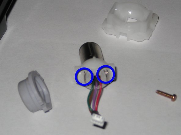

  4. Nintendo WaveBird Wireless Controller Receiver Teardown, Controller pinout: crwdns2935265:04crwdnd2935265:01crwdnd2935265:01crwdne2935265:0
    • Red: 3.43V logic supply (pin 1 on cable)
    • Brown: Ground (pin 3 on cable)
    • Green: Data (pin 2 on cable, recessed by 2mm into connector)
    • Violet: Shield (pin 4 on cable)

Hello. I have 2 receivers that only have three pins. Just below the Data pin there is nothing there...not as your pictures show. I bought a wavebird on ebay and it wont work. How can both of my receivers be missing a pin? I treat them like gold because I know these are not manufactured by Nintendo anymore. So it looks like the 2mm into connectors are missing. What? How?
cllonyx - crwdns2934203:0crwdne2934203:0
The Wavebird receiver only needs 3.3volts, data and ground to operate so that's why there is only 3 pins.
If you gave more details on whats happening it would be much easier to diagnose the problem.
