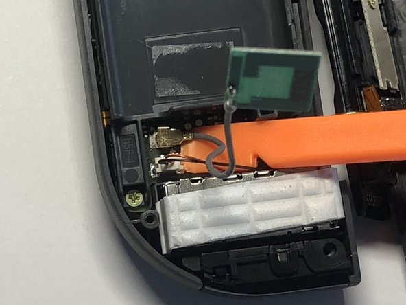

    • Pull the Bluetooth antenna out of its compartment and out of the way of the battery.
    • Using a plastic opening tool, lift the battery up and out of its compartment from the right edge.
    • The battery is held in place by adhesive tape and may take a bit of force to remove.
    • Be careful not to pull the battery or antenna out completely as they are still connected to the motherboard.

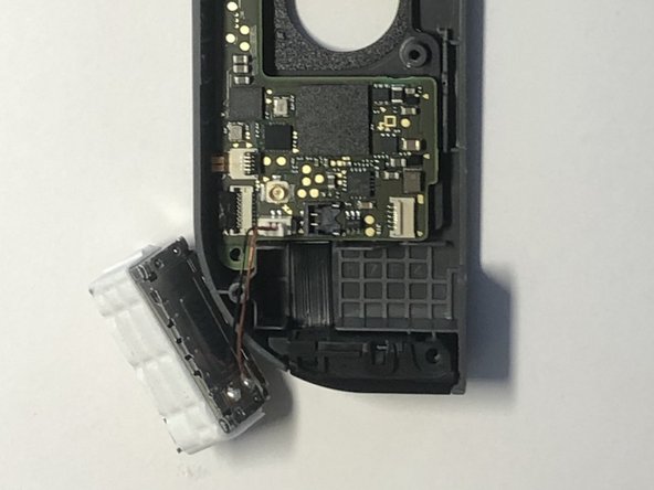

    • Using a spudger, gently pry upwards on both the left and right sides of the vibrator.
    • The vibrator is held in place with adhesive so it may take a bit of force to remove.
    • Once the vibrator is removed from its holder do not disconnect the cable. Instead, just move it to the side.

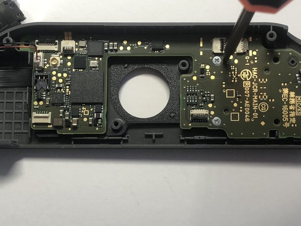

  12. Nintendo Switch Right Joy-Con Buttons Replacement: crwdns2935265:012crwdnd2935265:01crwdnd2935265:02crwdne2935265:0 Nintendo Switch Right Joy-Con Buttons Replacement: crwdns2935265:012crwdnd2935265:02crwdnd2935265:02crwdne2935265:0
    • Using a Phillips #2 screwdriver, remove the two 1.5 mm screws holding the motherboard in place.
    • Be careful as this is the only thing holding the buttons down and they will become loose once the screws are removed.

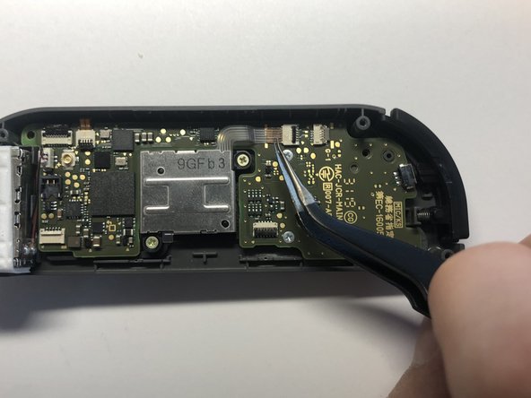

  13. Nintendo Switch Right Joy-Con Buttons Replacement: crwdns2935265:013crwdnd2935265:01crwdnd2935265:02crwdne2935265:0 Nintendo Switch Right Joy-Con Buttons Replacement: crwdns2935265:013crwdnd2935265:02crwdnd2935265:02crwdne2935265:0
    • Carefully lift the motherboard up and away from the casing.
    • Be cautious of the two remaining ribbon cables. If you pull too hard you will risk damaging the cables.
    • Using tweezers, gently lift the clasps holding the ribbon cables in place.
    • Slide the ribbon cables out of their connectors to release the motherboard from the casing.
