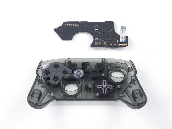

    1. Nintendo Switch Pro Controller Front Button Replacement, Remove the screws: crwdns2935265:012crwdnd2935265:01crwdnd2935265:01crwdne2935265:0
      • Remove the two 6.8 mm-long screws on the top circuit board using a Phillips screwdriver.
    2. Nintendo Switch Pro Controller Front Button Replacement, Open the ZIF connector: crwdns2935265:013crwdnd2935265:01crwdnd2935265:02crwdne2935265:0 Nintendo Switch Pro Controller Front Button Replacement, Open the ZIF connector: crwdns2935265:013crwdnd2935265:02crwdnd2935265:02crwdne2935265:0
      • Use a spudger to flip up the locking tab on the ZIF connector.
    3. Nintendo Switch Pro Controller Front Button Replacement: crwdns2935265:014crwdnd2935265:01crwdnd2935265:02crwdne2935265:0 Nintendo Switch Pro Controller Front Button Replacement: crwdns2935265:014crwdnd2935265:02crwdnd2935265:02crwdne2935265:0
      • Remove the black ribbon cable from its connector.
      • Only a small amount of force should be needed to remove the ribbon cable.
    4. Nintendo Switch Pro Controller Front Button Replacement: crwdns2935265:015crwdnd2935265:01crwdnd2935265:02crwdne2935265:0 Nintendo Switch Pro Controller Front Button Replacement: crwdns2935265:015crwdnd2935265:02crwdnd2935265:02crwdne2935265:0
      • Remove the trigger buttons from the plastic cover.
    1. Nintendo Switch Pro Controller Front Button Replacement, Unscrew front button board: crwdns2935265:016crwdnd2935265:01crwdnd2935265:01crwdne2935265:0
      • Use a Phillips screwdriver to remove the 5 mm-long screw securing the front button board.
      • There may be an additional screw. If so, remove it now.
    2. Nintendo Switch Pro Controller Front Button Replacement, Remove the board: crwdns2935265:017crwdnd2935265:01crwdnd2935265:02crwdne2935265:0 Nintendo Switch Pro Controller Front Button Replacement, Remove the board: crwdns2935265:017crwdnd2935265:02crwdnd2935265:02crwdne2935265:0
      • Remove the front button board.
