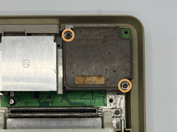

  3. Nintendo Super Famicom SHVC-001 Sound Card Replacement, Sound Card: crwdns2935265:03crwdnd2935265:01crwdnd2935265:02crwdne2935265:0 Nintendo Super Famicom SHVC-001 Sound Card Replacement, Sound Card: crwdns2935265:03crwdnd2935265:02crwdnd2935265:02crwdne2935265:0
    • The sound card is located in the top right corner of the device.
    • Remove the two 15.6 mm Phillips screws that secure the sound card.

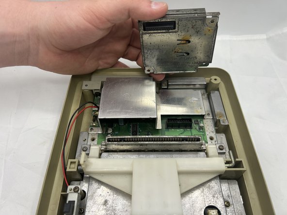

  4. Nintendo Super Famicom SHVC-001 Sound Card Replacement: crwdns2935265:04crwdnd2935265:01crwdnd2935265:02crwdne2935265:0 Nintendo Super Famicom SHVC-001 Sound Card Replacement: crwdns2935265:04crwdnd2935265:02crwdnd2935265:02crwdne2935265:0
    • Lift the sound card up and out of the chassis.
