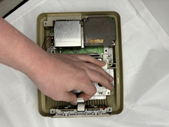

    • Remove the six 13.5 mm screws on the lower case with a 4.5 mm Gamebit screwdriver.
  2. Nintendo Super Famicom SHVC-001 Controller Port Board Replacement: crwdns2935265:02crwdnd2935265:01crwdnd2935265:02crwdne2935265:0 Nintendo Super Famicom SHVC-001 Controller Port Board Replacement: crwdns2935265:02crwdnd2935265:02crwdnd2935265:02crwdne2935265:0
    • Flip the Famicom over and set it down.
    • Lift off the upper case.
  3. Nintendo Super Famicom SHVC-001 Controller Port Board Replacement, Controller Port Board: crwdns2935265:03crwdnd2935265:01crwdnd2935265:02crwdne2935265:0 Nintendo Super Famicom SHVC-001 Controller Port Board Replacement, Controller Port Board: crwdns2935265:03crwdnd2935265:02crwdnd2935265:02crwdne2935265:0
    • Carefully disconnect the ribbon cable that is attached to the controller board and the main board.
  4. Nintendo Super Famicom SHVC-001 Controller Port Board Replacement: crwdns2935265:04crwdnd2935265:01crwdnd2935265:01crwdne2935265:0
    • Lift the controller port board directly up and out of the chassis.
    • If your new controller port board does not come with a ribbon cable, you will also need to replace that.
  5. Nintendo Super Famicom SHVC-001 Controller Port Board Replacement: crwdns2935265:05crwdnd2935265:01crwdnd2935265:03crwdne2935265:0 Nintendo Super Famicom SHVC-001 Controller Port Board Replacement: crwdns2935265:05crwdnd2935265:02crwdnd2935265:03crwdne2935265:0 Nintendo Super Famicom SHVC-001 Controller Port Board Replacement: crwdns2935265:05crwdnd2935265:03crwdnd2935265:03crwdne2935265:0
    • The next bullet demonstrates how to replace your ribbon cable.
    • Disconnect and remove the old cable and replace it with a new 1.25 mm ribbon cable.
