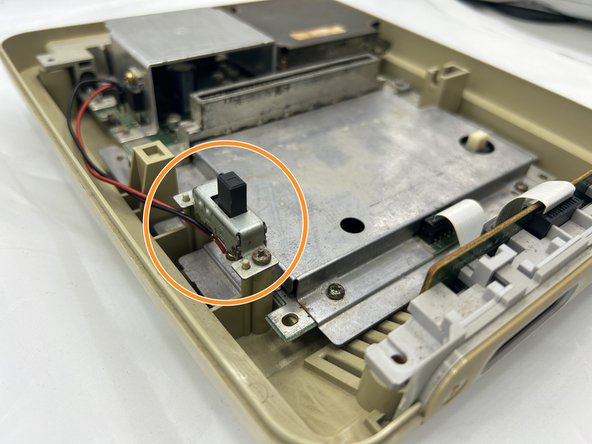

    • Use a Phillips screwdriver to remove the two screws that secure the power switch.
    • The power switch is connected to the main board via a little plastic connection; grip the motherboard connector and pull it straight out of its port.
    • Do not pull on the wires to avoid harming them. Instead, pull on the plastic connector.

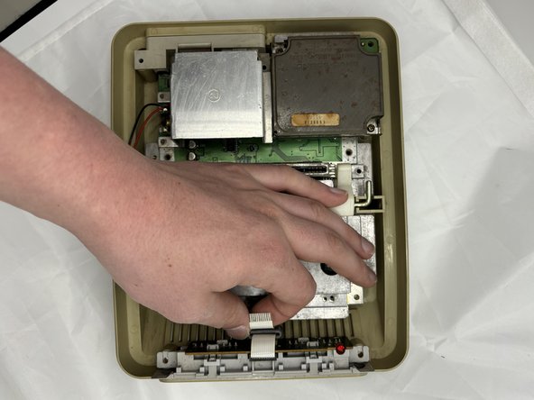

    • Carefully pull the ribbon cable that is attached to the controller board and the main board.
    • Remove the controller port.

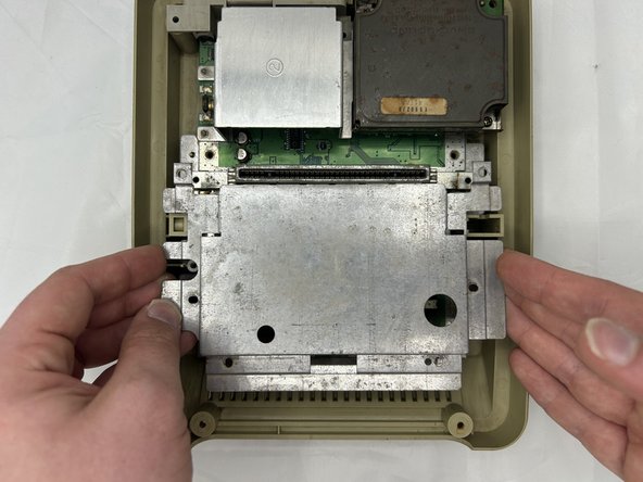

    • Use a Phillips screwdriver to remove the six 15.6 mm screws that secure the silver protective shield.
    • Remove the silver shield.

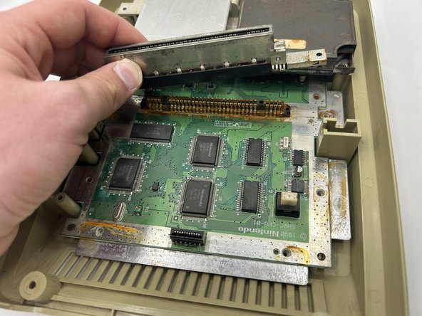

    • Lift the cartridge slot up and out of the device.

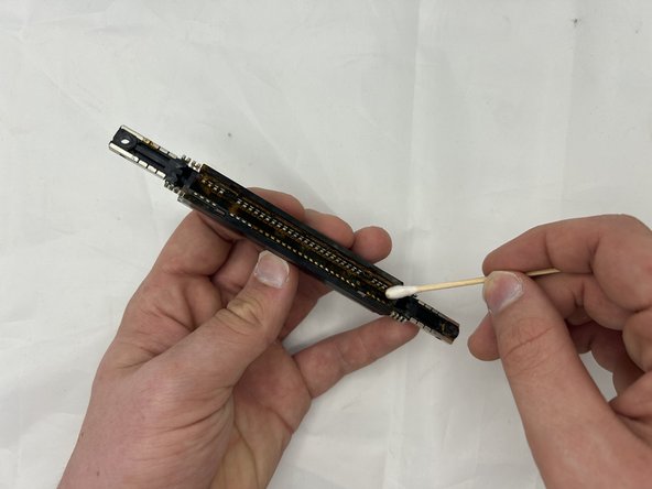

    • If the contacts are rusted or corroded, use a cotton swab damp with high-concentration isopropyl alcohol to remove the rust.
