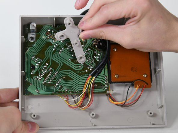

    1. Nintendo NES Advantage Start Button Replacement, Circuit Board: crwdns2935265:03crwdnd2935265:01crwdnd2935265:02crwdne2935265:0 Nintendo NES Advantage Start Button Replacement, Circuit Board: crwdns2935265:03crwdnd2935265:02crwdnd2935265:02crwdne2935265:0
      • Remove the three 14 mm screws from the gray cross with a Phillips #0 screwdriver.
      • Lift the gray component away from the device.

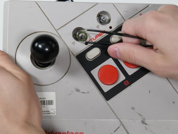

    3. Nintendo NES Advantage Start Button Replacement: crwdns2935265:05crwdnd2935265:01crwdnd2935265:03crwdne2935265:0 Nintendo NES Advantage Start Button Replacement: crwdns2935265:05crwdnd2935265:02crwdnd2935265:03crwdne2935265:0 Nintendo NES Advantage Start Button Replacement: crwdns2935265:05crwdnd2935265:03crwdnd2935265:03crwdne2935265:0
      • Remove the two silver knobs on the front of the device.
      • Unscrew the two silver nuts using a flathead screwdriver.
      • Remove each silver nut and silver washer using a pair of tweezers.

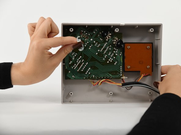

    4. Nintendo NES Advantage Start Button Replacement: crwdns2935265:06crwdnd2935265:01crwdnd2935265:02crwdne2935265:0 Nintendo NES Advantage Start Button Replacement: crwdns2935265:06crwdnd2935265:02crwdnd2935265:02crwdne2935265:0
      • Remove the remaining three 8 mm screws on the circuit board with a Phillips #0 screwdriver.
      • Remove the silver bracket from the top of the circuit board.
    5. Nintendo NES Advantage Start Button Replacement: crwdns2935265:07crwdnd2935265:01crwdnd2935265:01crwdne2935265:0
      • Remove the circuit board from the controller.
