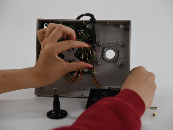

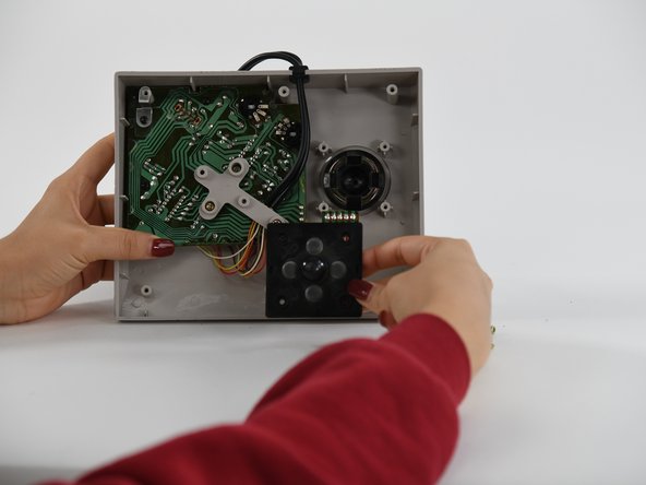

    1. Nintendo NES Advantage Joystick Spring Replacement, Joystick Panel: crwdns2935265:03crwdnd2935265:01crwdnd2935265:01crwdne2935265:0
      • Remove the four 12 mm screws from the small square panel on the right with a Phillips #0 screwdriver.
      • While removing the last (fourth) screw, apply downward pressure on the panel. This will make it easier to remove the last screw because of the joystick spring on the other side of this panel.
    2. Nintendo NES Advantage Joystick Spring Replacement: crwdns2935265:04crwdnd2935265:01crwdnd2935265:02crwdne2935265:0 Nintendo NES Advantage Joystick Spring Replacement: crwdns2935265:04crwdnd2935265:02crwdnd2935265:02crwdne2935265:0
      • Remove the small square panel.
      • This panel is connected with wires to the main circuit board. To replace the joystick panel, you will need to desolder the wires. To learn more about soldering, refer to our How To Solder and Desolder Connections guide.

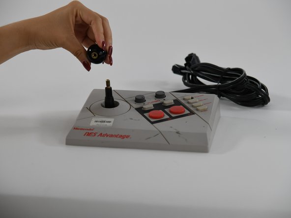

    1. Nintendo NES Advantage Joystick Spring Replacement, Joystick: crwdns2935265:05crwdnd2935265:01crwdnd2935265:02crwdne2935265:0 Nintendo NES Advantage Joystick Spring Replacement, Joystick: crwdns2935265:05crwdnd2935265:02crwdnd2935265:02crwdne2935265:0
      • Using your hands, unscrew the ball on top of the joystick.

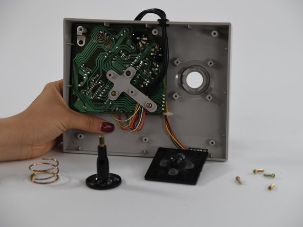

    1. Nintendo NES Advantage Joystick Spring Replacement, Joystick Spring: crwdns2935265:07crwdnd2935265:01crwdnd2935265:03crwdne2935265:0 Nintendo NES Advantage Joystick Spring Replacement, Joystick Spring: crwdns2935265:07crwdnd2935265:02crwdnd2935265:03crwdne2935265:0 Nintendo NES Advantage Joystick Spring Replacement, Joystick Spring: crwdns2935265:07crwdnd2935265:03crwdnd2935265:03crwdne2935265:0
      • Using your fingers, pull the spring up and off.
