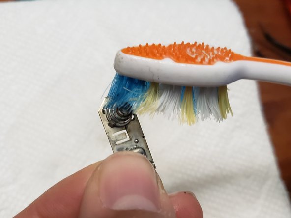

    6. Nintendo Gameboy Pocket Shell-Side Battery Terminal Corrosion Removal: crwdns2935265:06crwdnd2935265:01crwdnd2935265:02crwdne2935265:0 Nintendo Gameboy Pocket Shell-Side Battery Terminal Corrosion Removal: crwdns2935265:06crwdnd2935265:02crwdnd2935265:02crwdne2935265:0
      • Add isopropyl alcohol to a toothbrush.
      • Spread a paper towel down to keep your workspace clean.
      • Scrub the terminal where the corrosion is to remove as much as possible. If most of the corrosion is removed, skip to step 10.

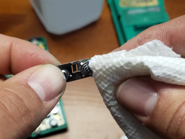

    8. Nintendo Gameboy Pocket Shell-Side Battery Terminal Corrosion Removal: crwdns2935265:08crwdnd2935265:01crwdnd2935265:02crwdne2935265:0 Nintendo Gameboy Pocket Shell-Side Battery Terminal Corrosion Removal: crwdns2935265:08crwdnd2935265:02crwdnd2935265:02crwdne2935265:0
      • Add metal polish to a paper towel.
      • Polish the battery terminal to remove the remainder of the corrosion.

Thank you for the guide! Resurrected a Gameboy Pocket today that has graphical glitches on the boot screen and sometimes crashed mid-game when a cartridge could load. This process seems to have completely remediated that.
I only needed to complete through step 6 to get clean shiny contacts in my case.
