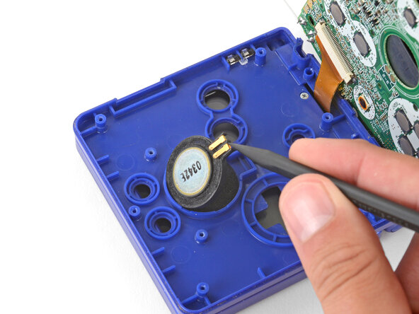

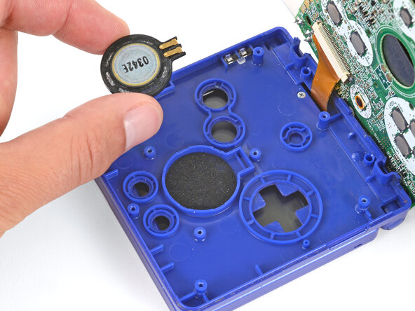

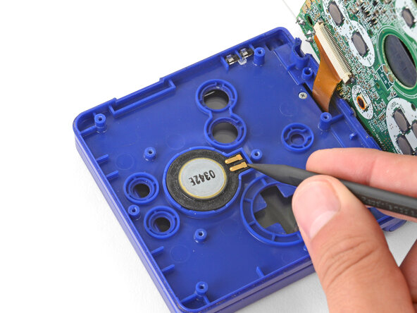

  7. Nintendo Game Boy Advance SP Brightness Switch Replacement, Remove the speaker: crwdns2935265:07crwdnd2935265:01crwdnd2935265:03crwdne2935265:0 Nintendo Game Boy Advance SP Brightness Switch Replacement, Remove the speaker: crwdns2935265:07crwdnd2935265:02crwdnd2935265:03crwdne2935265:0 Nintendo Game Boy Advance SP Brightness Switch Replacement, Remove the speaker: crwdns2935265:07crwdnd2935265:03crwdnd2935265:03crwdne2935265:0
    • Use the point of a spudger or a clean fingernail to lift the speaker until you can grip it with your fingers.
    • Remove the speaker.

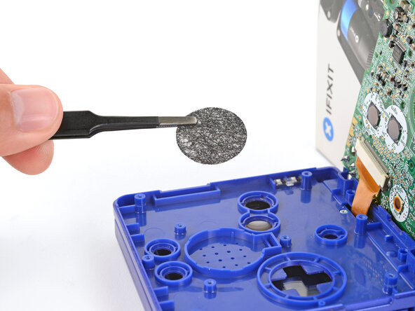

  8. Nintendo Game Boy Advance SP Brightness Switch Replacement, Prop up the main body: crwdns2935265:08crwdnd2935265:01crwdnd2935265:01crwdne2935265:0
    • Remove the circular mesh from the speaker recess and set it aside—the piece can easily fall out and get lost when working.

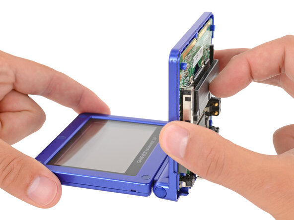

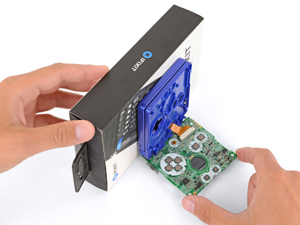

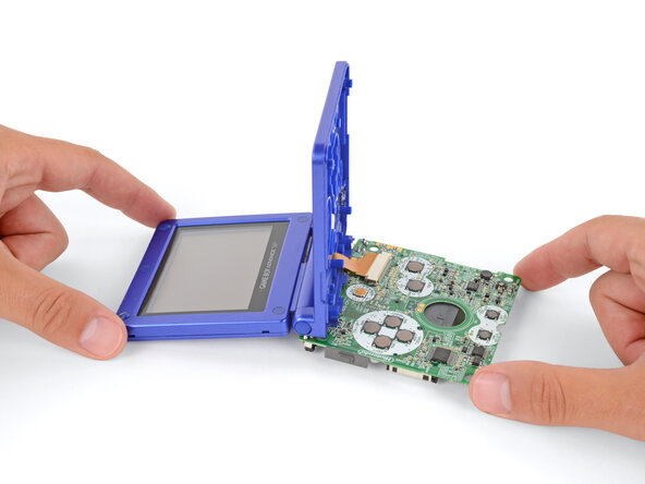

  9. Nintendo Game Boy Advance SP Brightness Switch Replacement, Prop up the main body: crwdns2935265:09crwdnd2935265:01crwdnd2935265:03crwdne2935265:0 Nintendo Game Boy Advance SP Brightness Switch Replacement, Prop up the main body: crwdns2935265:09crwdnd2935265:02crwdnd2935265:03crwdne2935265:0 Nintendo Game Boy Advance SP Brightness Switch Replacement, Prop up the main body: crwdns2935265:09crwdnd2935265:03crwdnd2935265:03crwdne2935265:0
    • Be careful not to strain the screen cable during the next few steps—it has very little slack.
    • You need to prop up the main body of your Game Boy in order to disconnect the screen cable without straining it. Here are two ways to do so:
    • Option 1: Open the main body of your Game Boy to a 90‑degree angle and gently lay the motherboard down. Make sure the main body is resting on top of the motherboard to give the cable slack.
    • Option 2: Keep the main body closed and prop it up on the edge of the logic board, using a sturdy object to hold it up.

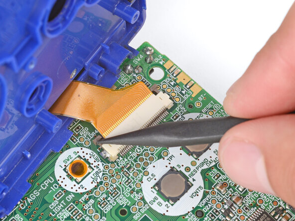

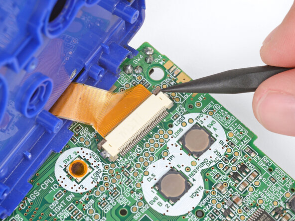

  10. Nintendo Game Boy Advance SP Brightness Switch Replacement, Disconnect the screen cable: crwdns2935265:010crwdnd2935265:01crwdnd2935265:03crwdne2935265:0 Nintendo Game Boy Advance SP Brightness Switch Replacement, Disconnect the screen cable: crwdns2935265:010crwdnd2935265:02crwdnd2935265:03crwdne2935265:0 Nintendo Game Boy Advance SP Brightness Switch Replacement, Disconnect the screen cable: crwdns2935265:010crwdnd2935265:03crwdnd2935265:03crwdne2935265:0
    • Use the point of a spudger to push the two tabs on either side of the screen cable connector into the unlocked position.
    • Only push the tabs until they stop. If you push them too far, you may slide the locking tab off the connector.

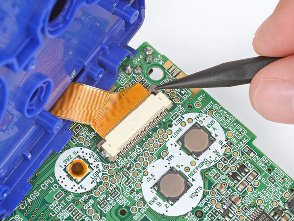

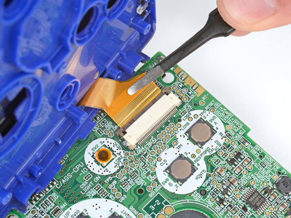

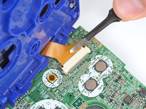

  11. Nintendo Game Boy Advance SP Brightness Switch Replacement: crwdns2935265:011crwdnd2935265:01crwdnd2935265:02crwdne2935265:0 Nintendo Game Boy Advance SP Brightness Switch Replacement: crwdns2935265:011crwdnd2935265:02crwdnd2935265:02crwdne2935265:0
    • Use a pair of tweezers to gently slide the screen cable out of its socket.

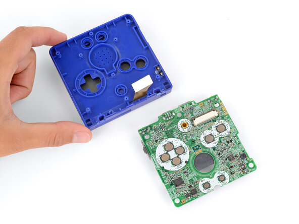

  12. Nintendo Game Boy Advance SP Brightness Switch Replacement, Remove the main body: crwdns2935265:012crwdnd2935265:01crwdnd2935265:01crwdne2935265:0
    • Remove the main body from the motherboard.
    • During reassembly, prop up the main body for enough slack reconnect the screen cable.
