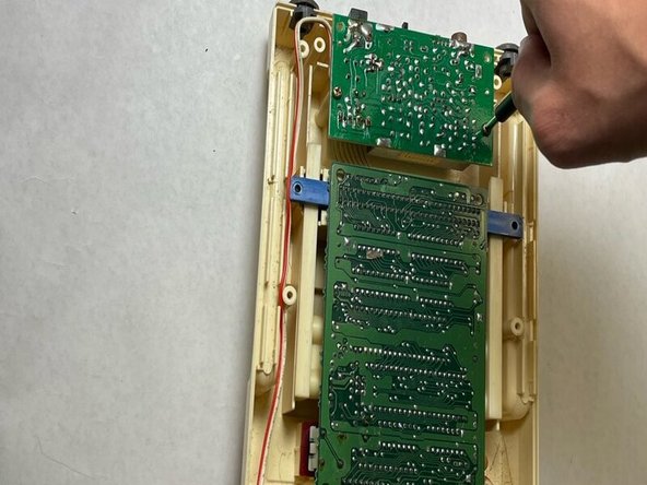

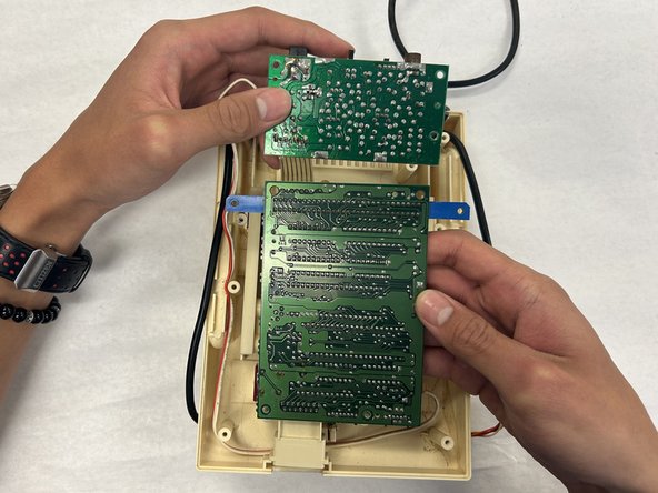

  4. Nintendo Family Computer (Famicom) Motherboard Replacement: crwdns2935265:04crwdnd2935265:01crwdnd2935265:03crwdne2935265:0 Nintendo Family Computer (Famicom) Motherboard Replacement: crwdns2935265:04crwdnd2935265:02crwdnd2935265:03crwdne2935265:0 Nintendo Family Computer (Famicom) Motherboard Replacement: crwdns2935265:04crwdnd2935265:03crwdnd2935265:03crwdne2935265:0
    • Remove the eight 13.5 mm Phillips screws that secure the motherboard.
    • Lift the motherboard up and out of the chassis.

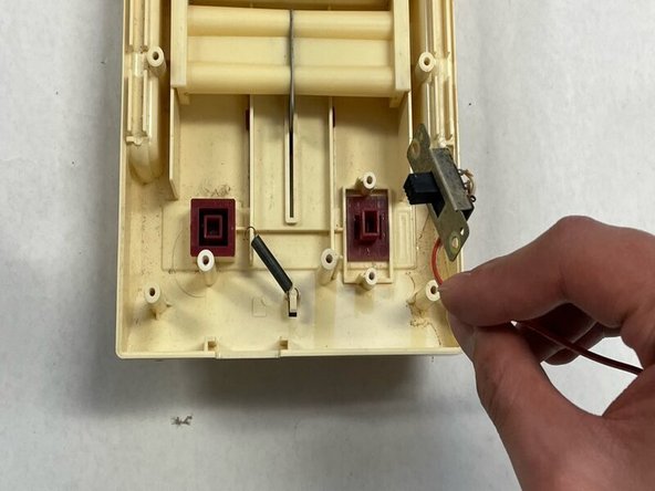

    • Remove the two 13.8 mm Phillips screws that secure the power switch.
    • The motherboard is connected to the power switch, and cannot be replaced without removing the switch. Forcibly removing the motherboard will only cause damage to the device
