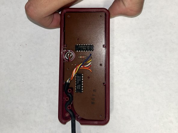

    • Use a Phillips screwdriver to remove the six 13.5 mm screws that secure the lower case.
    • Remove the lower case.
  2. Nintendo Family Computer (Famicom) Controller Motherboard Replacement: crwdns2935265:02crwdnd2935265:01crwdnd2935265:02crwdne2935265:0 Nintendo Family Computer (Famicom) Controller Motherboard Replacement: crwdns2935265:02crwdnd2935265:02crwdnd2935265:02crwdne2935265:0
    • Carefully disconnect the faulty controller's connector from the motherboard port.
    • Pull only on the connector; do not pull on the wires. The connector can be quite strenuous to remove. A pry tool or pliers may be helpful to disconnect the connector.
  3. Nintendo Family Computer (Famicom) Controller Motherboard Replacement: crwdns2935265:03crwdnd2935265:01crwdnd2935265:02crwdne2935265:0 Nintendo Family Computer (Famicom) Controller Motherboard Replacement: crwdns2935265:03crwdnd2935265:02crwdnd2935265:02crwdne2935265:0
    • Use a Phillips screwdriver to remove the six 9.3 mm screws from the back side of the controller.
    • Remove the back cover of the controller.
  4. Nintendo Family Computer (Famicom) Controller Motherboard Replacement: crwdns2935265:04crwdnd2935265:01crwdnd2935265:02crwdne2935265:0 Nintendo Family Computer (Famicom) Controller Motherboard Replacement: crwdns2935265:04crwdnd2935265:02crwdnd2935265:02crwdne2935265:0
    • Remove the controller motherboard, noting its orientation.
    • The Player 1 and Player 2 controller motherboards are not identical and differ from one another.
