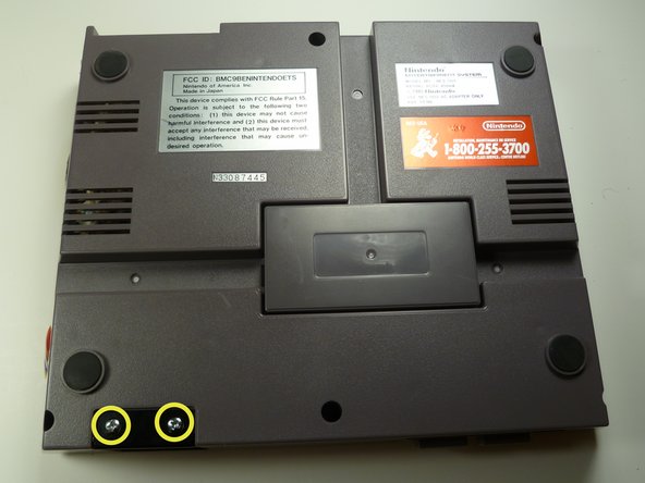

      • Flip the bottom cover of the game console over.
      • Remove the two 7.6mm Phillips screws that secure the plastic controller outlet cover with a Phillips head #2 screwdriver.
      • Pull the plastic cover off of the plastic NES case with your hands.

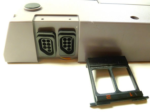

    2. Nintendo Entertainment System Controller Outlet Replacement: crwdns2935265:09crwdnd2935265:01crwdnd2935265:02crwdne2935265:0 Nintendo Entertainment System Controller Outlet Replacement: crwdns2935265:09crwdnd2935265:02crwdnd2935265:02crwdne2935265:0
      • Pull the controller outlet straight out with your hands, leaving an open hole in the plastic NES case.
