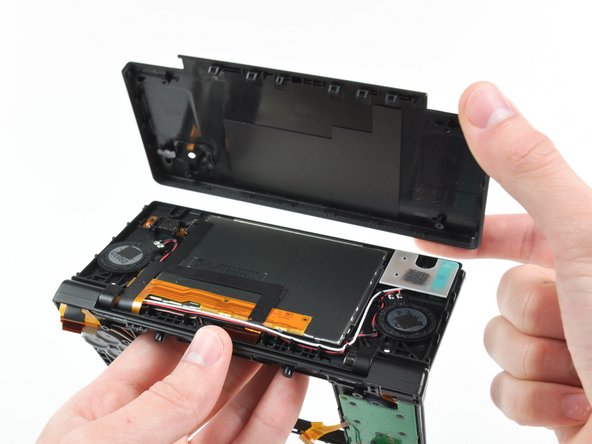

  16. Nintendo DSi Wi-Fi Antenna Board Replacement, Lower LCD Assembly: crwdns2935265:016crwdnd2935265:01crwdnd2935265:02crwdne2935265:0 Nintendo DSi Wi-Fi Antenna Board Replacement, Lower LCD Assembly: crwdns2935265:016crwdnd2935265:02crwdnd2935265:02crwdne2935265:0
    • Use the tip of a spudger to pry the metal backing of the lower LCD up from the DSi's framework.
    • Lift the lower LCD assembly out of the DSi.

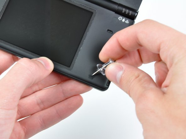

  17. Nintendo DSi Wi-Fi Antenna Board Replacement, Wi-Fi Antenna Board: crwdns2935265:017crwdnd2935265:01crwdnd2935265:02crwdne2935265:0 Nintendo DSi Wi-Fi Antenna Board Replacement, Wi-Fi Antenna Board: crwdns2935265:017crwdnd2935265:02crwdnd2935265:02crwdne2935265:0
    • Use a pushpin to remove the four plastic screw covers (highlighted in red) on the front bezel.

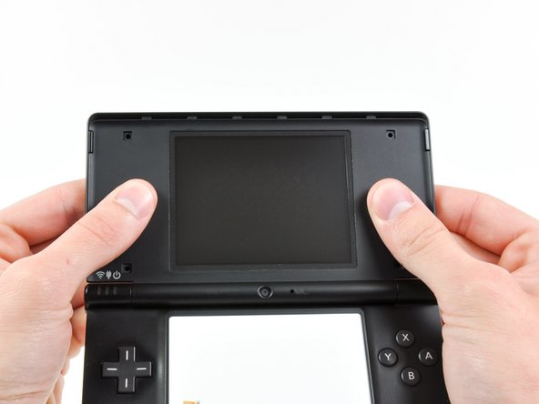

  19. Nintendo DSi Wi-Fi Antenna Board Replacement: crwdns2935265:019crwdnd2935265:01crwdnd2935265:03crwdne2935265:0 Nintendo DSi Wi-Fi Antenna Board Replacement: crwdns2935265:019crwdnd2935265:02crwdnd2935265:03crwdne2935265:0 Nintendo DSi Wi-Fi Antenna Board Replacement: crwdns2935265:019crwdnd2935265:03crwdnd2935265:03crwdne2935265:0
    • Using two hands, gently slide the rear bezel upwards.
    • The rear bezel will move only about 2 mm.
    • Lift the rear bezel straight up out of the DSi.

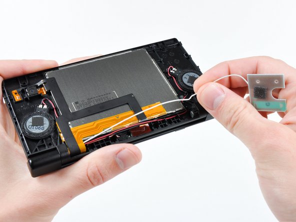

  20. Nintendo DSi Wi-Fi Antenna Board Replacement: crwdns2935265:020crwdnd2935265:01crwdnd2935265:01crwdne2935265:0
    • De-route the Wi-Fi antenna cable from its slot in the bottom front bezel.
  21. Nintendo DSi Wi-Fi Antenna Board Replacement: crwdns2935265:021crwdnd2935265:01crwdnd2935265:02crwdne2935265:0 Nintendo DSi Wi-Fi Antenna Board Replacement: crwdns2935265:021crwdnd2935265:02crwdnd2935265:02crwdne2935265:0
    • Lift the Wi-Fi board off its mounting posts on the top front bezel.
    • De-route the Wi-Fi antenna cable through the hinge and remove it from the DSi.
