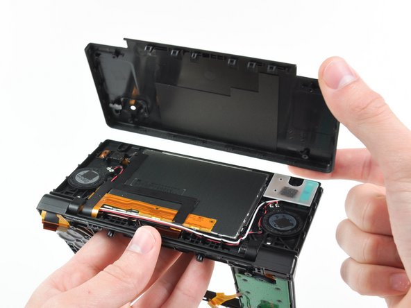

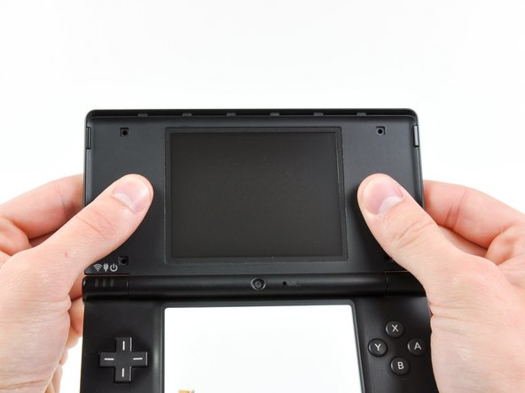

  19. Nintendo DSi Upper LCD/Speakers Replacement: crwdns2935265:019crwdnd2935265:01crwdnd2935265:03crwdne2935265:0 Nintendo DSi Upper LCD/Speakers Replacement: crwdns2935265:019crwdnd2935265:02crwdnd2935265:03crwdne2935265:0 Nintendo DSi Upper LCD/Speakers Replacement: crwdns2935265:019crwdnd2935265:03crwdnd2935265:03crwdne2935265:0
    • Using two hands, gently slide the rear bezel upwards.
    • The rear bezel will move only about 2 mm.
    • Slightly close the case of the DSi and lift the rear bezel straight up out of the DSi.

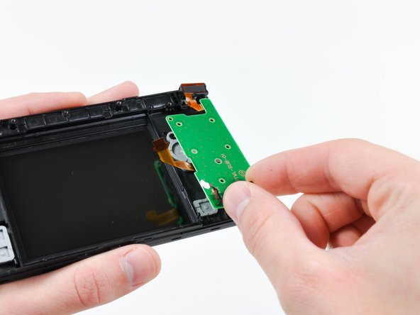

  21. Nintendo DSi Upper LCD/Speakers Replacement: crwdns2935265:021crwdnd2935265:01crwdnd2935265:02crwdne2935265:0 Nintendo DSi Upper LCD/Speakers Replacement: crwdns2935265:021crwdnd2935265:02crwdnd2935265:02crwdne2935265:0
    • Remove the five Phillips screws securing the power board to the DSi's framework.
    • Lift and remove the power board from the DSi.

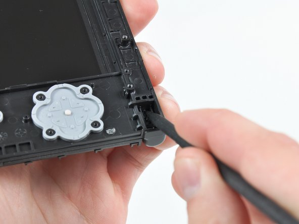

    • Push the metal hinge pin inward on the D-pad side of the front lower panel with the tip of a spudger.
    • The pin should move about 3 mm and stop. It is not necessary to try to completely remove the pin.

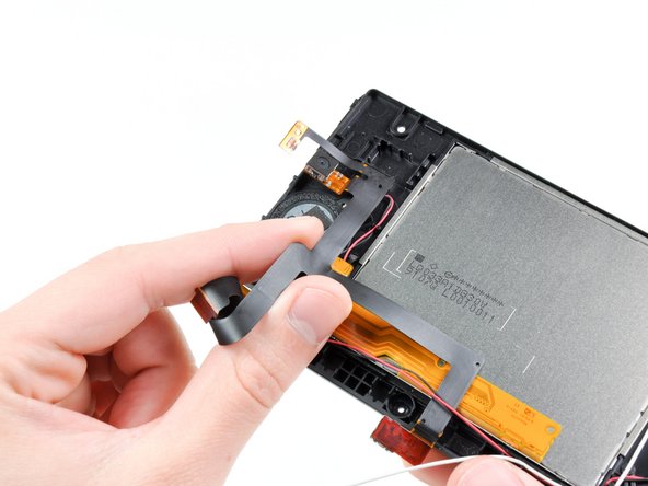

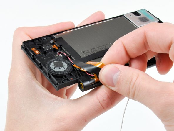

  25. Nintendo DSi Upper LCD/Speakers Replacement: crwdns2935265:025crwdnd2935265:01crwdnd2935265:02crwdne2935265:0 Nintendo DSi Upper LCD/Speakers Replacement: crwdns2935265:025crwdnd2935265:02crwdnd2935265:02crwdne2935265:0
    • Tightly coil the display and dual camera ribbon cables enough to push them through the steel hinge tube.
    • Remove the steel hinge tube.
    • Carefully push both coiled ribbon cables through the tube molded into the front upper panel.

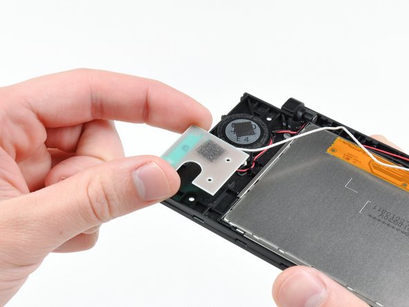

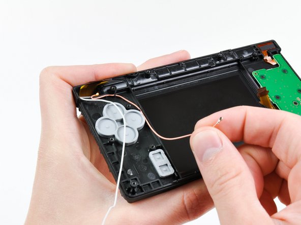

    • De-route the Wi-Fi antenna cable from its channel in the front bezel.
    • Lift the Wi-Fi antenna board straight up and remove it from the DSi.

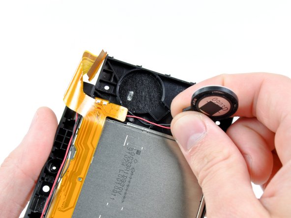

  29. Nintendo DSi Upper LCD/Speakers Replacement: crwdns2935265:029crwdnd2935265:01crwdnd2935265:02crwdne2935265:0 Nintendo DSi Upper LCD/Speakers Replacement: crwdns2935265:029crwdnd2935265:02crwdnd2935265:02crwdne2935265:0
    • Use the flat end of a spudger to pry the right speaker straight up and out of its housing in the front upper panel.
    • Lift the right speaker and set it on top of the upper LCD.

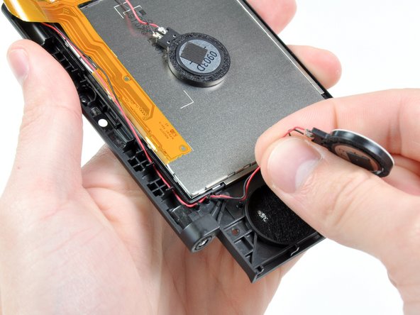

  30. Nintendo DSi Upper LCD/Speakers Replacement: crwdns2935265:030crwdnd2935265:01crwdnd2935265:02crwdne2935265:0 Nintendo DSi Upper LCD/Speakers Replacement: crwdns2935265:030crwdnd2935265:02crwdnd2935265:02crwdne2935265:0
    • In the same manner as previously described, remove the left speaker.
    • De-route the left speaker cables from underneath the upper LCD.
    • Lay the left speaker on top of the upper LCD.

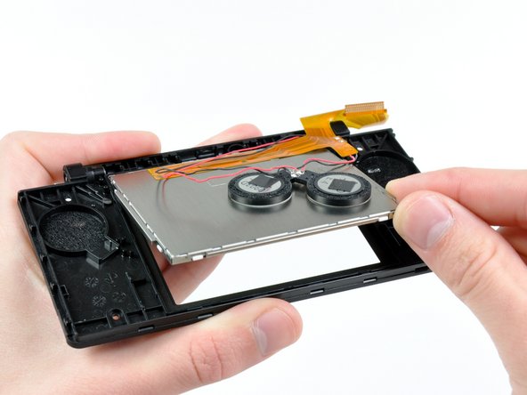

  31. Nintendo DSi Upper LCD/Speakers Replacement: crwdns2935265:031crwdnd2935265:01crwdnd2935265:02crwdne2935265:0 Nintendo DSi Upper LCD/Speakers Replacement: crwdns2935265:031crwdnd2935265:02crwdnd2935265:02crwdne2935265:0
    • Cautiously wedge the flat end of spudger underneath the upper LCD.
    • Loosen the adhesive by running the spudger along the perimeter of the upper LCD.
    • Lift the upper LCD by its upper right corner and remove it from the front upper panel.
  32. Nintendo DSi Upper LCD/Speakers Replacement: crwdns2935265:032crwdnd2935265:01crwdnd2935265:01crwdne2935265:0
    • Desolder the speakers from the upper LCD by heating up the solder joints with a soldering iron and simultaneously using a pair of tweezers to pull the speaker wires away from the logic board.
    • If you have never soldered before, we have a guide that makes it easy.
