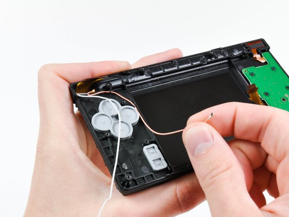

    • De-route the Wi-Fi and microphone cables from the slot molded into the bottom front bezel.
  21. Nintendo DSi Microphone Replacement: crwdns2935265:021crwdnd2935265:01crwdnd2935265:02crwdne2935265:0 Nintendo DSi Microphone Replacement: crwdns2935265:021crwdnd2935265:02crwdnd2935265:02crwdne2935265:0
    • Use the tip of a spudger to gently lift the microphone out of its housing in the top front bezel.
    • De-route the microphone cable through the hinge and remove it from the DSi.
