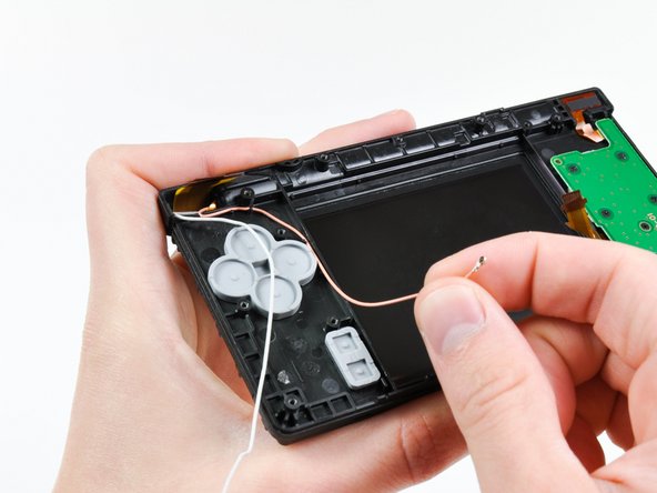

    • De-route the microphone and Wi-Fi antenna cables through the opening located on the bottom DSi's framework.

  24. Nintendo DSi Dual Camera Assembly Replacement: crwdns2935265:024crwdnd2935265:01crwdnd2935265:01crwdne2935265:0
    • Using your fingers, grasp the microphone cable and remove it from the front bezel assembly.
    • The microphone will likely pop out of its housing, so it is probably easier to completely remove it at this point.
    • De-route the Wi-Fi antenna cable through the hinge.
