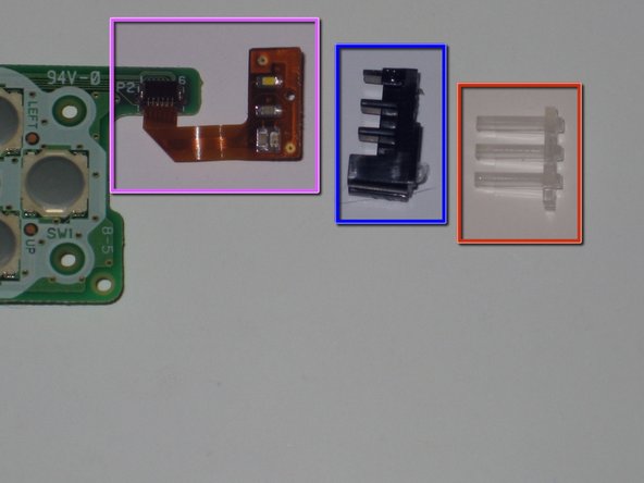

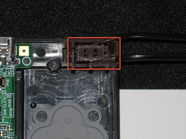

    • Insert a 1.5mm flat-head screwdriver into the notch to the right of the LED assembly, and pry the black plastic frame out of the case.
    • Using some tweezers to pull out the clear plastic light pipe assembly.
    • The orange flex cable (with the LEDs) is attached to the black plastic frame with adhesive; if you accidentally pull the cable off the plastic frame, pull the plastic frame and light pipe out with tweezers and reassemble them.
