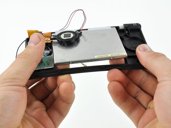

  26. Nintendo DS Lite Wi-Fi Antenna Replacement, Wi-Fi Antenna: crwdns2935265:026crwdnd2935265:01crwdnd2935265:03crwdne2935265:0 Nintendo DS Lite Wi-Fi Antenna Replacement, Wi-Fi Antenna: crwdns2935265:026crwdnd2935265:02crwdnd2935265:03crwdne2935265:0 Nintendo DS Lite Wi-Fi Antenna Replacement, Wi-Fi Antenna: crwdns2935265:026crwdnd2935265:03crwdnd2935265:03crwdne2935265:0
    • Use the tip of a spudger to pry both speakers up from their housing and place them on the back of the LCD.
    • The speakers have magnets which will hold them together, helping to keep them out of the way for later steps.

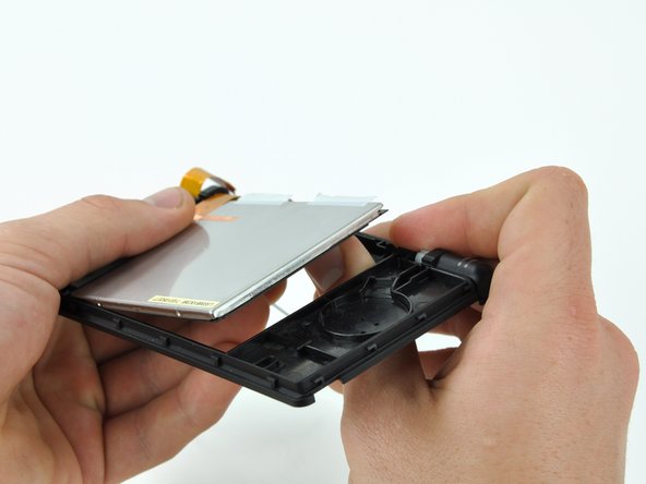

  27. Nintendo DS Lite Wi-Fi Antenna Replacement: crwdns2935265:027crwdnd2935265:01crwdnd2935265:03crwdne2935265:0 Nintendo DS Lite Wi-Fi Antenna Replacement: crwdns2935265:027crwdnd2935265:02crwdnd2935265:03crwdne2935265:0 Nintendo DS Lite Wi-Fi Antenna Replacement: crwdns2935265:027crwdnd2935265:03crwdnd2935265:03crwdne2935265:0
    • Starting in the top right corner, use both hands to slowly separate the LCD from the front display bezel.
    • Continue separating along the top and left edges of the LCD.
    • Finally, push the LCD up and away from the front display bezel.
    • Do not try to remove the LCD yet, as it is still connected to the front display bezel via the LCD ribbon cable.

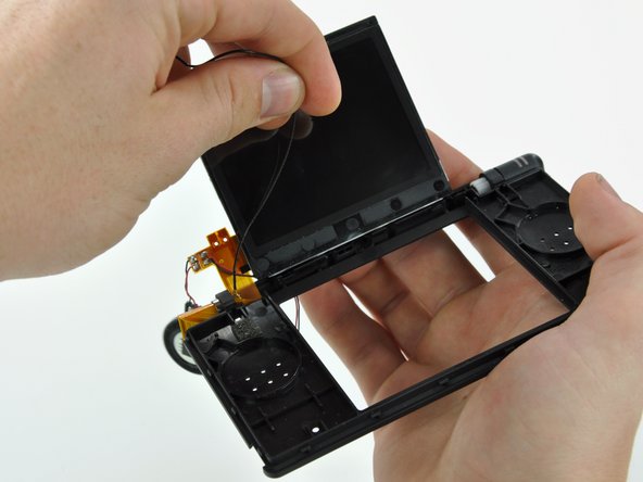

  28. Nintendo DS Lite Wi-Fi Antenna Replacement: crwdns2935265:028crwdnd2935265:01crwdnd2935265:03crwdne2935265:0 Nintendo DS Lite Wi-Fi Antenna Replacement: crwdns2935265:028crwdnd2935265:02crwdnd2935265:03crwdne2935265:0 Nintendo DS Lite Wi-Fi Antenna Replacement: crwdns2935265:028crwdnd2935265:03crwdnd2935265:03crwdne2935265:0
    • Lift the Wi-Fi antenna up, and pull its cable through the hole in the front display bezel.
    • Remove the Wi-Fi antenna from the display assembly.
