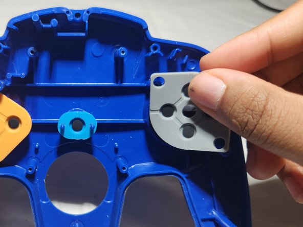

  4. Nintendo 64 Controller D-Pad Replacement: crwdns2935265:04crwdnd2935265:01crwdnd2935265:03crwdne2935265:0 Nintendo 64 Controller D-Pad Replacement: crwdns2935265:04crwdnd2935265:02crwdnd2935265:03crwdne2935265:0 Nintendo 64 Controller D-Pad Replacement: crwdns2935265:04crwdnd2935265:03crwdnd2935265:03crwdne2935265:0
    • Slide the rubber pad off that covers the back of the D-pad.
    • Remove the broken D-pad from its socket.
  5. Nintendo 64 Controller D-Pad Replacement: crwdns2935265:05crwdnd2935265:01crwdnd2935265:03crwdne2935265:0 Nintendo 64 Controller D-Pad Replacement: crwdns2935265:05crwdnd2935265:02crwdnd2935265:03crwdne2935265:0 Nintendo 64 Controller D-Pad Replacement: crwdns2935265:05crwdnd2935265:03crwdnd2935265:03crwdne2935265:0
    • Insert the replacement D-pad into the socket.
    • Stretch the rubber backing onto the plastic pieces and slide it down over the D-pad.
