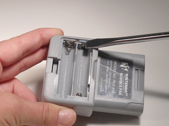

    • Remove the Rumble Pak from the controller by pressing the release button and pulling the Rumble Pak out.
  2. Nintendo 64  Rumble Pak Battery Replacement: crwdns2935265:02crwdnd2935265:01crwdnd2935265:01crwdne2935265:0
    • Remove the battery cover from the Rumble Pak by pressing the tab and pulling the cover up.
  3. Nintendo 64  Rumble Pak Battery Replacement: crwdns2935265:03crwdnd2935265:01crwdnd2935265:01crwdne2935265:0
    • Press each battery toward the spring, then pull toward you to remove the batteries from the Rumble Pak.
    • When inserting the new batteries, make sure the positive (+) end of the battery touches the flat piece, and the negative (-) end touches the spring.
  4. Nintendo 64  Rumble Pak Battery Replacement: crwdns2935265:04crwdnd2935265:01crwdnd2935265:03crwdne2935265:0 Nintendo 64  Rumble Pak Battery Replacement: crwdns2935265:04crwdnd2935265:02crwdnd2935265:03crwdne2935265:0 Nintendo 64  Rumble Pak Battery Replacement: crwdns2935265:04crwdnd2935265:03crwdnd2935265:03crwdne2935265:0
    • Check for corrosion around the springs and the flat plate where the batteries touch.
    • Do not touch the corrosion. It may be battery acid.
    • Use a flat head screwdriver to chisel away the corrosion, and use a Q-tip to wipe it clean.
    • Do not use water to wet the Q-tip, as water can damage the Rumble Pak.
