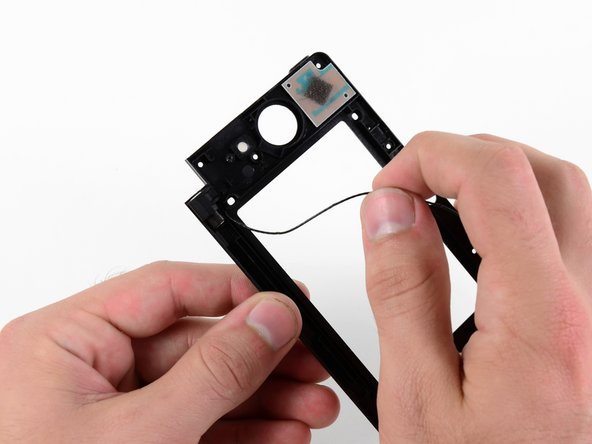

  22. Nintendo 3DS Wi-Fi Antenna Replacement: crwdns2935265:022crwdnd2935265:01crwdnd2935265:02crwdne2935265:0 Nintendo 3DS Wi-Fi Antenna Replacement: crwdns2935265:022crwdnd2935265:02crwdnd2935265:02crwdne2935265:0
    • De-route the Wi-Fi antenna cable from the bottom of the upper case.
    • This step is not necessary if you are only replacing the front panel; however, the replacement of the upper screen, speakers, cameras, and Wi-Fi antenna require it.

  40. Nintendo 3DS Wi-Fi Antenna Replacement, Wi-Fi Antenna: crwdns2935265:040crwdnd2935265:01crwdnd2935265:02crwdne2935265:0 Nintendo 3DS Wi-Fi Antenna Replacement, Wi-Fi Antenna: crwdns2935265:040crwdnd2935265:02crwdnd2935265:02crwdne2935265:0
    • Pull the Wi-Fi antenna cable through its hole in the upper display bezel.
    • De-route the Wi-Fi antenna cable from the upper display bezel.
  41. Nintendo 3DS Wi-Fi Antenna Replacement: crwdns2935265:041crwdnd2935265:01crwdnd2935265:01crwdne2935265:0
    • Remove the Wi-Fi antenna from the upper display bezel.
