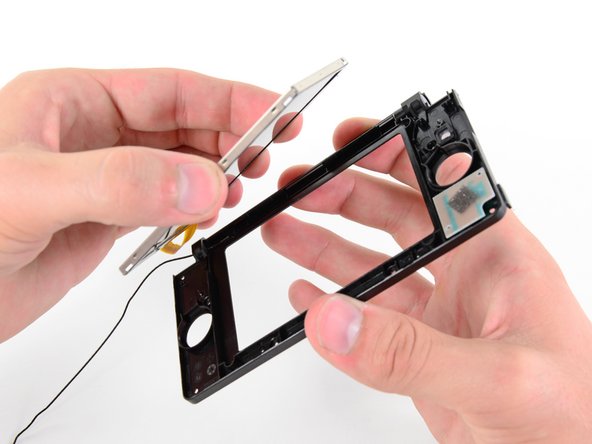

    1. Nintendo 3DS Upper LCD Replacement, Cameras: crwdns2935265:036crwdnd2935265:01crwdnd2935265:02crwdne2935265:0 Nintendo 3DS Upper LCD Replacement, Cameras: crwdns2935265:036crwdnd2935265:02crwdnd2935265:02crwdne2935265:0
      • Gently roll the upper LCD ribbon cable and camera ribbon cable together and insert them into the hinge opening.
    2. Nintendo 3DS Upper LCD Replacement: crwdns2935265:037crwdnd2935265:01crwdnd2935265:03crwdne2935265:0 Nintendo 3DS Upper LCD Replacement: crwdns2935265:037crwdnd2935265:02crwdnd2935265:03crwdne2935265:0 Nintendo 3DS Upper LCD Replacement: crwdns2935265:037crwdnd2935265:03crwdnd2935265:03crwdne2935265:0
      • Use a pair of metal tweezers to remove the black metal hinge ring from the upper display bezel.
      • Carefully pull the camera and upper LCD ribbon cables through their hole in the upper display bezel.

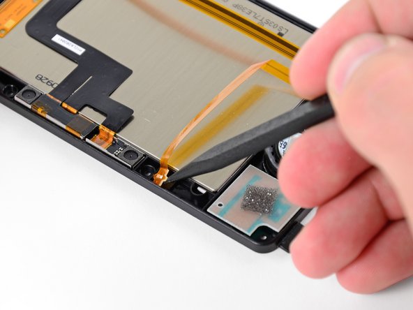

    3. Nintendo 3DS Upper LCD Replacement: crwdns2935265:038crwdnd2935265:01crwdnd2935265:02crwdne2935265:0 Nintendo 3DS Upper LCD Replacement: crwdns2935265:038crwdnd2935265:02crwdnd2935265:02crwdne2935265:0
      • Peel the camera ribbon cable off the back of the upper LCD.
      • The ribbon cable is held to the back of the LCD housing by an adhesive, so pull on it gently to avoid tearing the ribbon cable.
      • Remove the camera ribbon cable assembly.

      • Use your thumbs to push the upper LCD from the front out of the upper display bezel.
      • Remove the upper LCD.
    2. Nintendo 3DS Upper LCD Replacement: crwdns2935265:040crwdnd2935265:01crwdnd2935265:01crwdne2935265:0
      • A strip of black adhesive tape holds the upper LCD to the display bezel. Use the tip of a spudger to remove the tape from the LCD housing.
