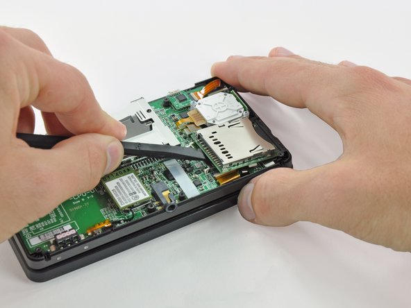

  6. Nintendo 3DS SD Board Replacement, SD Board: crwdns2935265:06crwdnd2935265:01crwdnd2935265:01crwdne2935265:0
    • Remove the two 4.5 mm Phillips screws securing the SD board to the motherboard.
  7. Nintendo 3DS SD Board Replacement: crwdns2935265:07crwdnd2935265:01crwdnd2935265:02crwdne2935265:0 Nintendo 3DS SD Board Replacement: crwdns2935265:07crwdnd2935265:02crwdnd2935265:02crwdne2935265:0
    • The connector for the SD board sits underneath the Circle Pad ribbon cable.
    • Use the flat end of a spudger to pry the SD board ribbon cable connector off its socket on the motherboard.
  8. Nintendo 3DS SD Board Replacement: crwdns2935265:08crwdnd2935265:01crwdnd2935265:03crwdne2935265:0 Nintendo 3DS SD Board Replacement: crwdns2935265:08crwdnd2935265:02crwdnd2935265:03crwdne2935265:0 Nintendo 3DS SD Board Replacement: crwdns2935265:08crwdnd2935265:03crwdnd2935265:03crwdne2935265:0
    • Insert the flat end of a spudger between the SD board and the motherboard.
    • Run the spudger along the sides of the SD board to free it from the adhesive pad holding it in place.
    • Once completely freed, lift the SD board straight off the motherboard.
