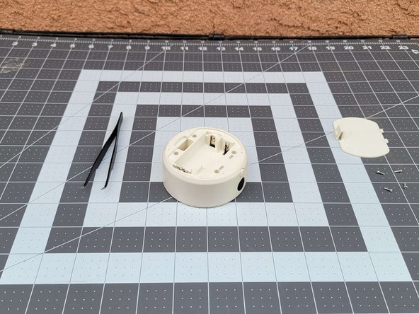

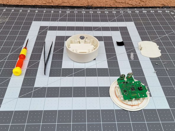

    • Flip the adapter so the bottom side faces up.
    • Remove the cover by pressing the plastic flap and lifting it up with one finger.
  2. Nintendo 3DS NFC Reader Motherboard Replacement: crwdns2935265:02crwdnd2935265:01crwdnd2935265:03crwdne2935265:0 Nintendo 3DS NFC Reader Motherboard Replacement: crwdns2935265:02crwdnd2935265:02crwdnd2935265:03crwdne2935265:0 Nintendo 3DS NFC Reader Motherboard Replacement: crwdns2935265:02crwdnd2935265:03crwdnd2935265:03crwdne2935265:0
    • Remove the batteries by pressing the positive side towards the negative side and lifting with one finger.
  3. Nintendo 3DS NFC Reader Motherboard Replacement: crwdns2935265:03crwdnd2935265:01crwdnd2935265:03crwdne2935265:0 Nintendo 3DS NFC Reader Motherboard Replacement: crwdns2935265:03crwdnd2935265:02crwdnd2935265:03crwdne2935265:0 Nintendo 3DS NFC Reader Motherboard Replacement: crwdns2935265:03crwdnd2935265:03crwdnd2935265:03crwdne2935265:0

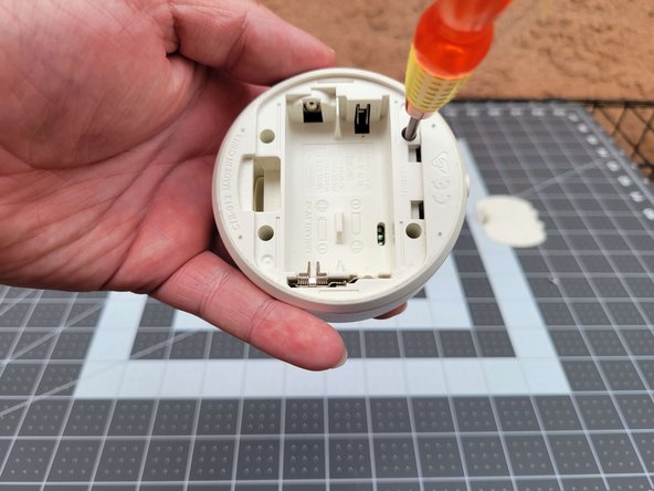

    • Grab your tri-point screwdriver.
    • Locate the four holes containing the tri-point screws at each corner of the adapter.
    • Using the screwdriver, unscrew all four screws.
    • Put the screws out of the way.

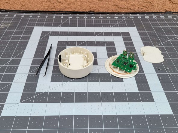

  4. Nintendo 3DS NFC Reader Motherboard Replacement: crwdns2935265:04crwdnd2935265:01crwdnd2935265:02crwdne2935265:0 Nintendo 3DS NFC Reader Motherboard Replacement: crwdns2935265:04crwdnd2935265:02crwdnd2935265:02crwdne2935265:0
    • After removing the screws, flip the adapter where the top side faces up.
    • Using your fingers, pull the top off of the adapter.
    • Place the top out of the way.
  5. Nintendo 3DS NFC Reader Motherboard Replacement: crwdns2935265:05crwdnd2935265:01crwdnd2935265:02crwdne2935265:0 Nintendo 3DS NFC Reader Motherboard Replacement: crwdns2935265:05crwdnd2935265:02crwdnd2935265:02crwdne2935265:0

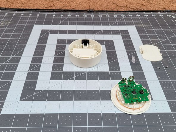

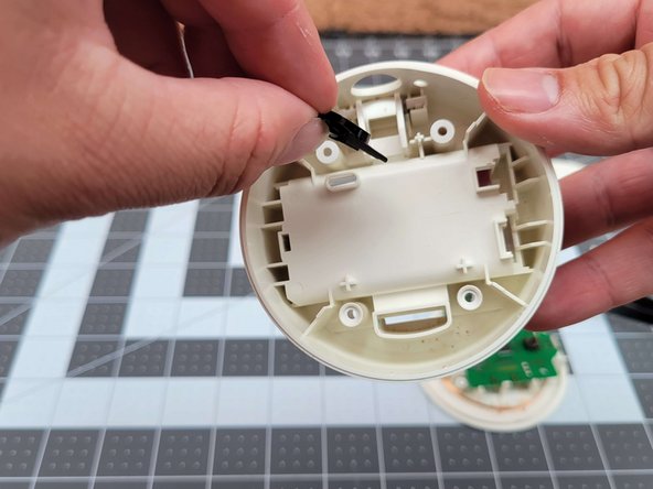

    • Using your tweezers, remove the translucent plastic by lifting upwards out of it's peg.
  6. Nintendo 3DS NFC Reader Motherboard Replacement: crwdns2935265:06crwdnd2935265:01crwdnd2935265:03crwdne2935265:0 Nintendo 3DS NFC Reader Motherboard Replacement: crwdns2935265:06crwdnd2935265:02crwdnd2935265:03crwdne2935265:0 Nintendo 3DS NFC Reader Motherboard Replacement: crwdns2935265:06crwdnd2935265:03crwdnd2935265:03crwdne2935265:0
    • To remove the black slide, use your fingers to slide the black slide out of its slot.
  7. Nintendo 3DS NFC Reader Motherboard Replacement: crwdns2935265:07crwdnd2935265:01crwdnd2935265:03crwdne2935265:0 Nintendo 3DS NFC Reader Motherboard Replacement: crwdns2935265:07crwdnd2935265:02crwdnd2935265:03crwdne2935265:0 Nintendo 3DS NFC Reader Motherboard Replacement: crwdns2935265:07crwdnd2935265:03crwdnd2935265:03crwdne2935265:0

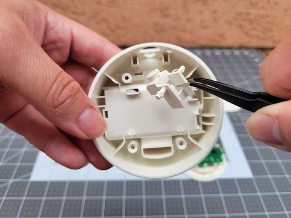

    • Using the tweezers, carefully lift up the plastic button out of its slot.
  8. Nintendo 3DS NFC Reader Motherboard Replacement: crwdns2935265:08crwdnd2935265:01crwdnd2935265:03crwdne2935265:0 Nintendo 3DS NFC Reader Motherboard Replacement: crwdns2935265:08crwdnd2935265:02crwdnd2935265:03crwdne2935265:0 Nintendo 3DS NFC Reader Motherboard Replacement: crwdns2935265:08crwdnd2935265:03crwdnd2935265:03crwdne2935265:0

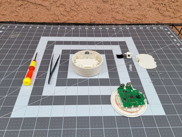

    • Using your tweezers, carefully loosen the copper wire from its plastic holder.
    • Then with the tweezers, remove the plastic holding the motherboard in place.
  9. Nintendo 3DS NFC Reader Motherboard Replacement: crwdns2935265:09crwdnd2935265:01crwdnd2935265:02crwdne2935265:0 Nintendo 3DS NFC Reader Motherboard Replacement: crwdns2935265:09crwdnd2935265:02crwdnd2935265:02crwdne2935265:0
    • Using your fingers, carefully lift the board and place it down, out of the way.
