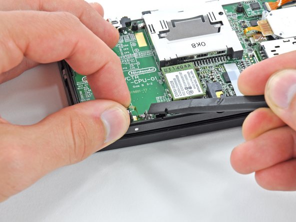

  5. Nintendo 3DS Microphone Replacement: crwdns2935265:05crwdnd2935265:01crwdnd2935265:03crwdne2935265:0 Nintendo 3DS Microphone Replacement: crwdns2935265:05crwdnd2935265:02crwdnd2935265:03crwdne2935265:0 Nintendo 3DS Microphone Replacement: crwdns2935265:05crwdnd2935265:03crwdnd2935265:03crwdne2935265:0
    • Lift the bottom edge of the lower case off the rest of the 3DS.
    • There are still two ribbon cables connecting the mother board to the case, so be sure not to pull the lower case all the way off.
    • Use a plastic opening tool to pry the shoulder button ribbon cables off their sockets on the motherboard.
    • Remove the lower case from the device.

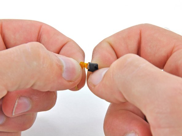

  6. Nintendo 3DS Microphone Replacement, Microphone: crwdns2935265:06crwdnd2935265:01crwdnd2935265:02crwdne2935265:0 Nintendo 3DS Microphone Replacement, Microphone: crwdns2935265:06crwdnd2935265:02crwdnd2935265:02crwdne2935265:0
    • Grasp the microphone ribbon cable near the microphone with a pair of tweezers.
    • Pull the microphone straight up out of the upper case.
  7. Nintendo 3DS Microphone Replacement: crwdns2935265:07crwdnd2935265:01crwdnd2935265:02crwdne2935265:0 Nintendo 3DS Microphone Replacement: crwdns2935265:07crwdnd2935265:02crwdnd2935265:02crwdne2935265:0
    • Use the flat end of a spudger or your fingernail to flip up the retaining flap on the Microphone ribbon cable ZIF socket.
  8. Nintendo 3DS Microphone Replacement: crwdns2935265:08crwdnd2935265:01crwdnd2935265:02crwdne2935265:0 Nintendo 3DS Microphone Replacement: crwdns2935265:08crwdnd2935265:02crwdnd2935265:02crwdne2935265:0
    • Lift the microphone and its attached ribbon cable off the motherboard.
    • If your replacement microphone doesn't come with a silicone cover, peel the cover off the original one and reuse it.

Can someone please tell me how to acquire a new microphone chip?
Grimmy Animates - crwdns2934203:0crwdne2934203:0
You are able to purchase replacement microphones on amazon for less than $10 USD
Julianne McBride -
Bad news, it's almost impossible to get a replacement for the original 3DS microphone.
Good news, I made one for the newer 3DSXL work and they are plentiful on Ebay.
What you need to do to make it work is trim the end of the cable on the edges to match the width of the original so it will fit in the socket. This requires very steady hands and a very sharp small diagonal cutter. Maybe get 2 mics in case you make a mistake. They are very cheap from China.
Note that the contacts face down on the cable and it slides in the hinge side of the clip. Again, very steady hands, a bright light and a tweezers are useful.
Finally you will need to make a gentle twist in the cable when inserting the mic into where it came from because mic is on the other side of the cable as from the original. Be very gentle with the latch on the connector. If you break it you are hosed.
