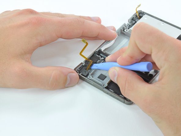

    • Insert a plastic opening tool under the left side of the left shoulder button cover.
    • Pry the black plastic cover up from the lower case.
    • Grab the cover and lift it off of the lower case.
    • If the shoulder button contact and ribbon cable come off with the cover, be sure to reinstall them in the correct orientation.

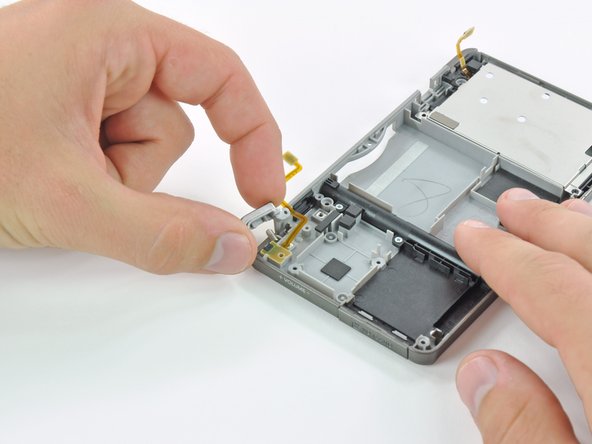

  8. Nintendo 3DS Left Shoulder Button Replacement: crwdns2935265:08crwdnd2935265:01crwdnd2935265:03crwdne2935265:0 Nintendo 3DS Left Shoulder Button Replacement: crwdns2935265:08crwdnd2935265:02crwdnd2935265:03crwdne2935265:0 Nintendo 3DS Left Shoulder Button Replacement: crwdns2935265:08crwdnd2935265:03crwdnd2935265:03crwdne2935265:0
    • Press lightly on the back of the button until it becomes unattached. Be careful not to lose the small spring and pin behind the plastic button.
