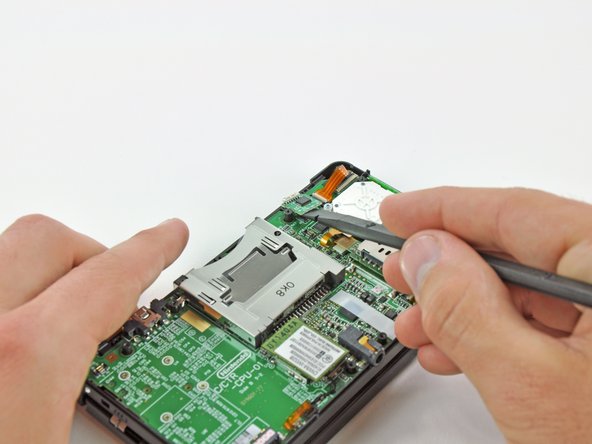

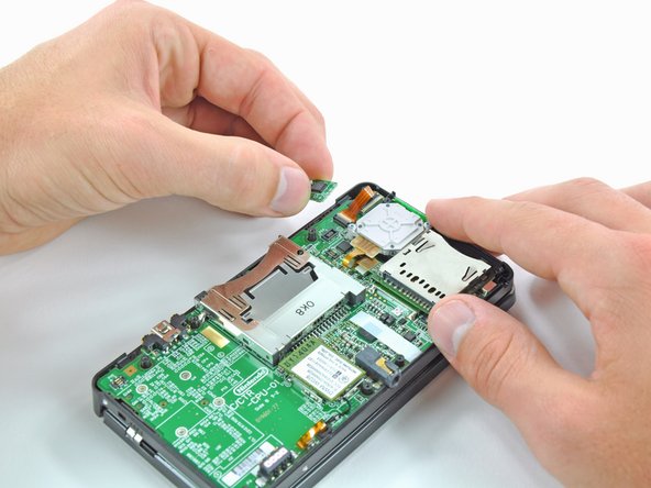

  6. Nintendo 3DS IR Board Replacement, IR Board: crwdns2935265:06crwdnd2935265:01crwdnd2935265:03crwdne2935265:0 Nintendo 3DS IR Board Replacement, IR Board: crwdns2935265:06crwdnd2935265:02crwdnd2935265:03crwdne2935265:0 Nintendo 3DS IR Board Replacement, IR Board: crwdns2935265:06crwdnd2935265:03crwdnd2935265:03crwdne2935265:0
    • Use the flat end of a spudger to lightly pry the IR board off the motherboard.
    • Grab the edges of the IR board with two fingers and lift it from the motherboard.
