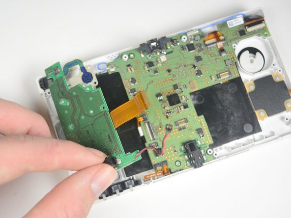

  10. Nintendo 3DS 2015 C-Stick Replacement, C-Stick: crwdns2935265:010crwdnd2935265:01crwdnd2935265:01crwdne2935265:0
    • Remove the four 3mm Phillips #00 screws.
    • Remove the three 3mm Phillips #00 screws.
  11. Nintendo 3DS 2015 C-Stick Replacement: crwdns2935265:011crwdnd2935265:01crwdnd2935265:03crwdne2935265:0 Nintendo 3DS 2015 C-Stick Replacement: crwdns2935265:011crwdnd2935265:02crwdnd2935265:03crwdne2935265:0 Nintendo 3DS 2015 C-Stick Replacement: crwdns2935265:011crwdnd2935265:03crwdnd2935265:03crwdne2935265:0
    • Pull up gently on power cable to loose it from the motherboard.
    • Pull the ribbon cable, connected to the mic, gently towards you with a pair of tweezers.
    • Lift the tab to free the large ribbon cable on just above the power connector.
  12. Nintendo 3DS 2015 C-Stick Replacement: crwdns2935265:012crwdnd2935265:01crwdnd2935265:02crwdne2935265:0 Nintendo 3DS 2015 C-Stick Replacement: crwdns2935265:012crwdnd2935265:02crwdnd2935265:02crwdne2935265:0
    • Pry the C-Stick from its plastic housing with the flat side of a spudger.
    • Lift the assembly gently out of the device from the battery connector at the bottom of the leftmost circuit board.
  13. Nintendo 3DS 2015 C-Stick Replacement: crwdns2935265:013crwdnd2935265:01crwdnd2935265:02crwdne2935265:0 Nintendo 3DS 2015 C-Stick Replacement: crwdns2935265:013crwdnd2935265:02crwdnd2935265:02crwdne2935265:0
    • Flip the board over to reveal the connector for the C-stick's ribbon cable.
    • Lift the tab on the ZIF connector securing the C-Stick to the board.
    • Separate the C-Stick from the board.
